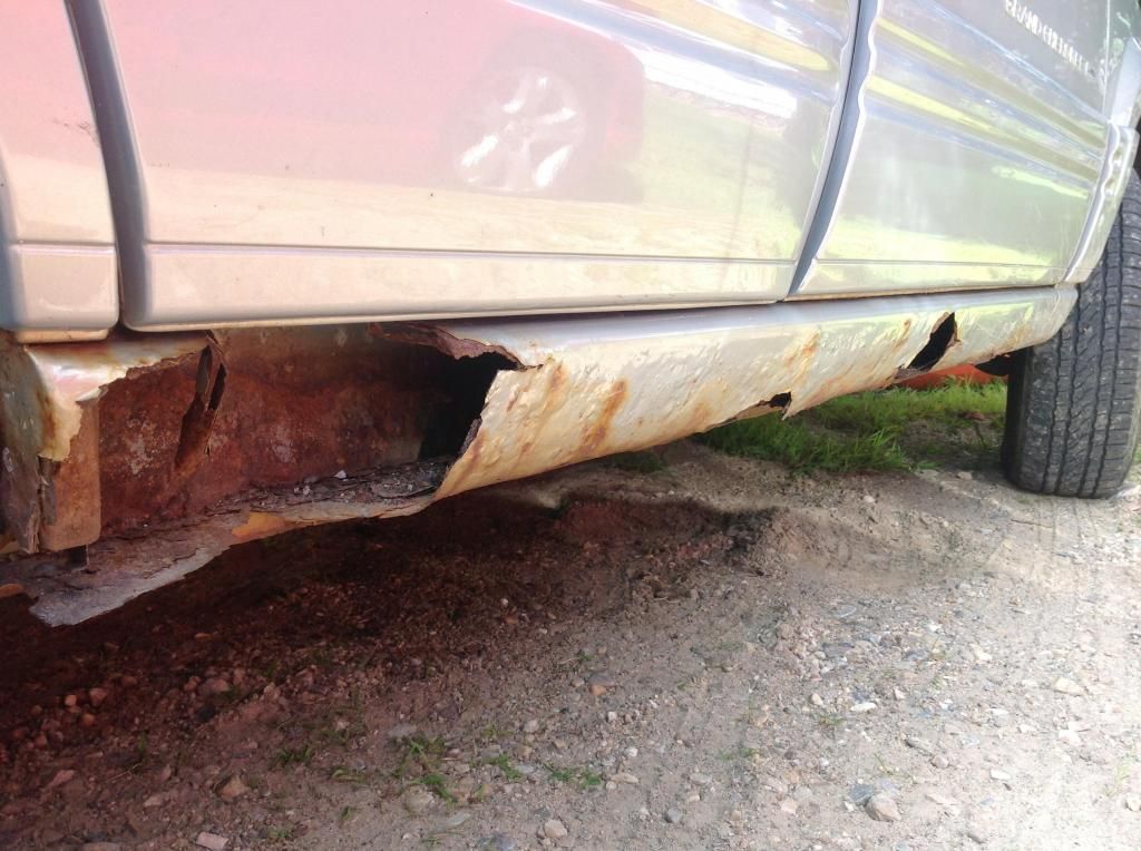

We pretty much drove it as we bought it till the end of 2013. The rocker panels were getting really bad it needed brakes. It had been a long time since I was interested in working on autos and I wasn't sure that the jeep was worth fixing. Then I thought about how great it was in the snow and how expensive a newer SUV would be so I took the plunge and decided to build her up. I did a decent amount of engine work in the past but no fabrication or bodywork so this was a big plunge for me.

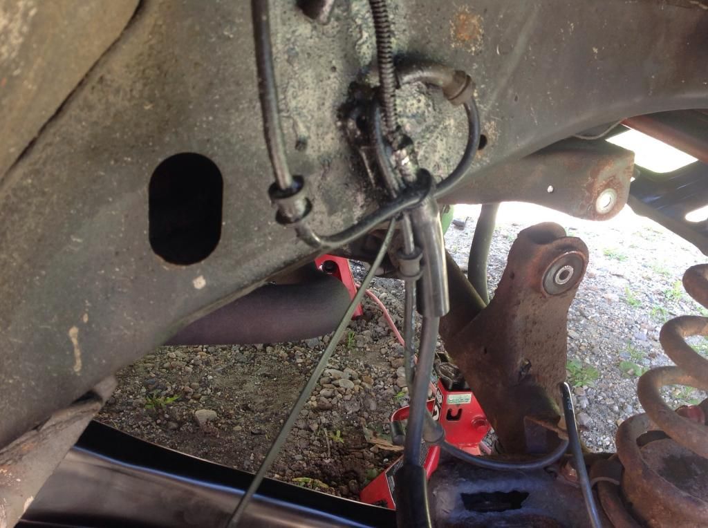

March, 2014 I replaced the rotors and pads on all four wheels as well as some rusty brake lines. My front caliper started sticking so I put in new front calipers and hoses. Rust had gotten into where the hose fitting connects to the hard line fitting so a two hour job turned into two days as I went to the JY and pulled non rusty front hardline fittings from a ZJ. The stock fittings are some weird metric with different threads and I couldn't find them locally which meant I couldn't just buy new fittings, hence, the need for the JY parts. Braking was vastly improved and I discovered the awesomeness of caliper grease. Brakes were a pretty new thing to me too so Jeepforum was a huge help.

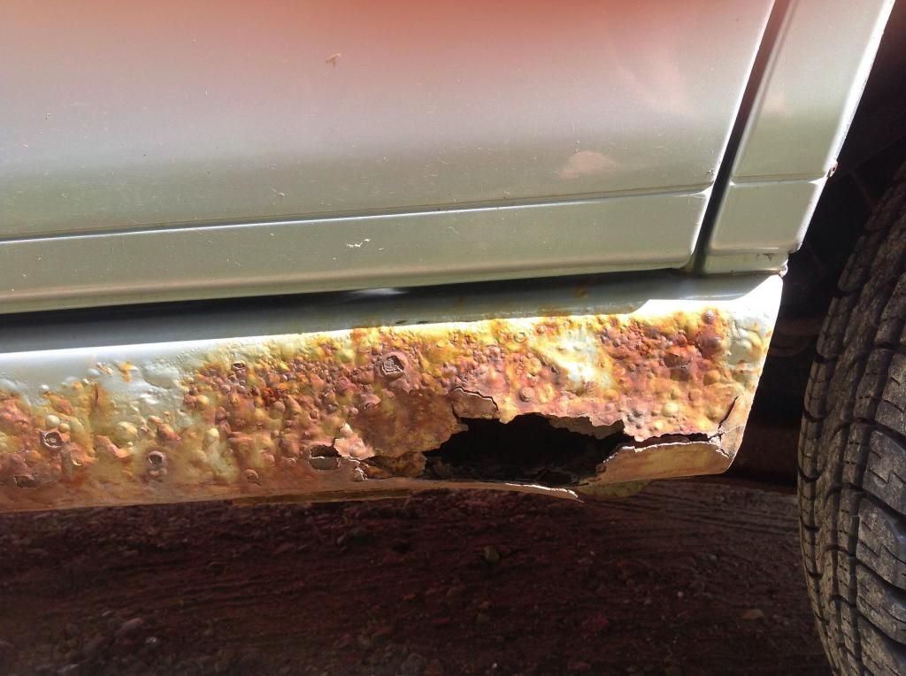

I then started doing a lot of research on how to fix the rocker panels. You could touch them with your foot and they would crumble away.
I decided to do 2x6 steel tube and tie into the pillars and unibody. The full write up is here http://www.jeepforum.com/forum/f13/r...anels-2401561/
That went pretty well for my first attempt at something like this

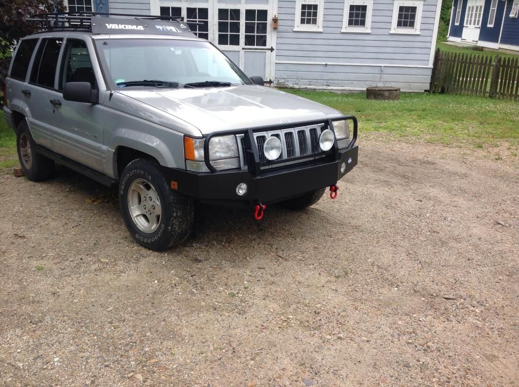

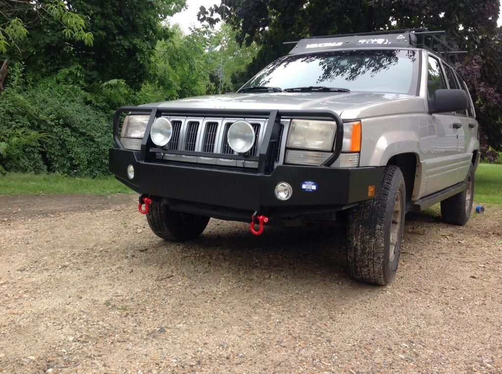

After the rack, I replaced the leaking front and rear output seals on the transfercase and wire wheeled the rust off my driveshafts and painted them. Then, I was still saving for lift, tires and parts so I started on a bumper. I really like how the ARB bumpers look so I copied a lot of their design. It took about 2 weeks to build and then I waited about two more weeks for the bull bar to get bent by a shop. Total cost was about 250.00 including the lights. The write-up is here: http://www.jeepforum.com/forum/f13/b...my-zj-2437913/
I am very happy with how it turned out. I didn't love the silver so I painted it black

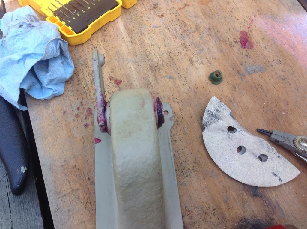

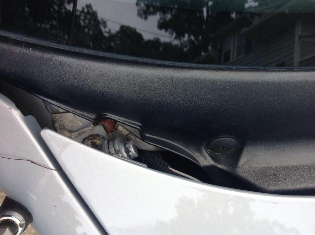

Then it rained really hard and my passenger side front floorboard had 2 inches of water in it. I vacuumed it out and did a little research and found this
I cleaned it up and siliconed the crap out of it and that fixed the problem

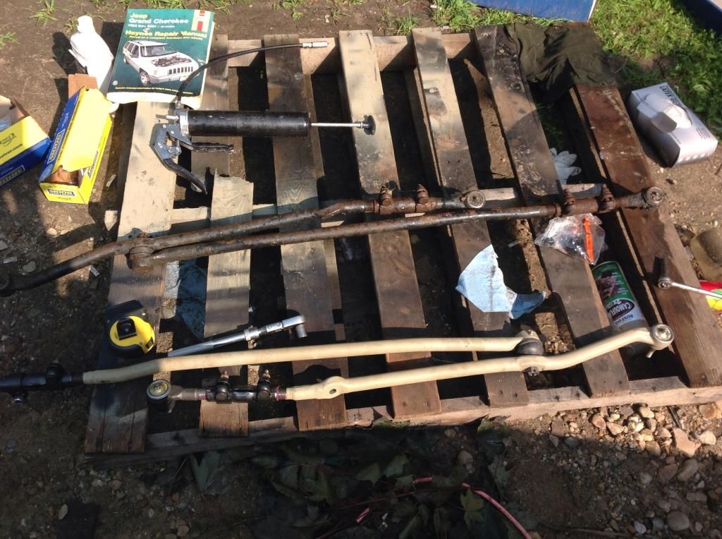

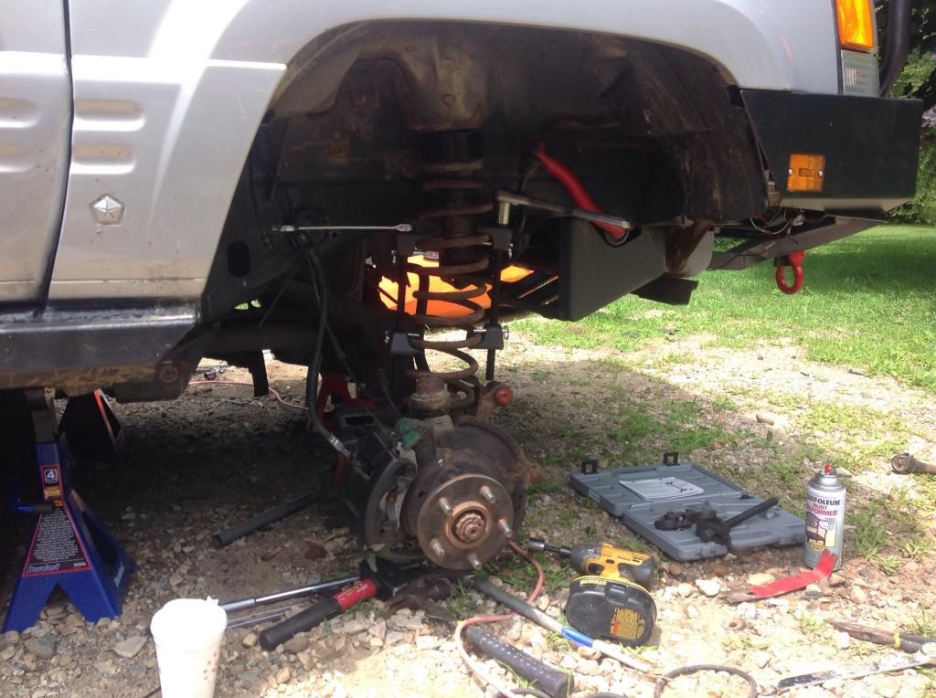

So then I had the money for new tires, a lift, and new suspension and steering. I did not want to lift it without replacing a bunch of key parts for safety and just common sense reasons. After all, it is a 16 year old vehicle. Everything went smoothly, it took about 12 hours total by myself. I replaced the rear lower control arms, front upper and lower control arms, trackbar, steering stabilizer, tie rod, drag link, and tie rod ends. For everything but the SS I went with Moog parts. The lift was the Rubicon Express 2" BB with their shocks. The old and new steering
Doing the upper control arm
Putting the spacer in
After everything was installed I got an alignment and ordered my new tires

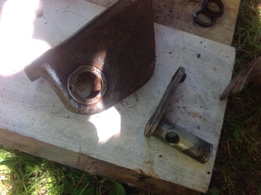

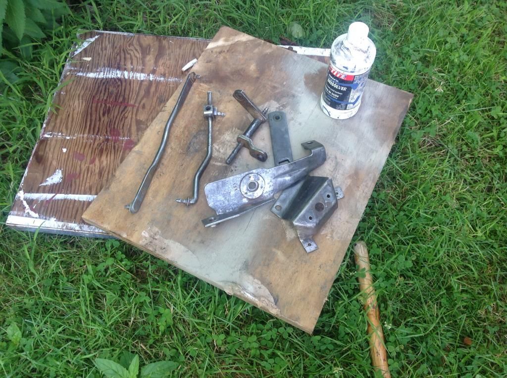

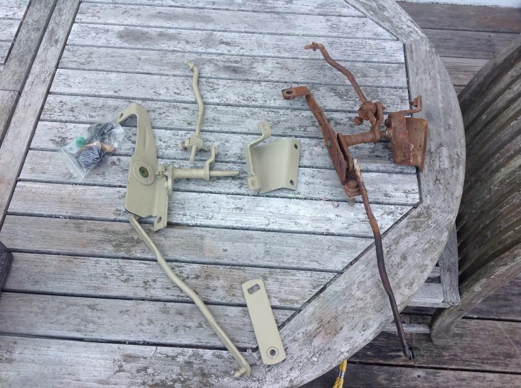

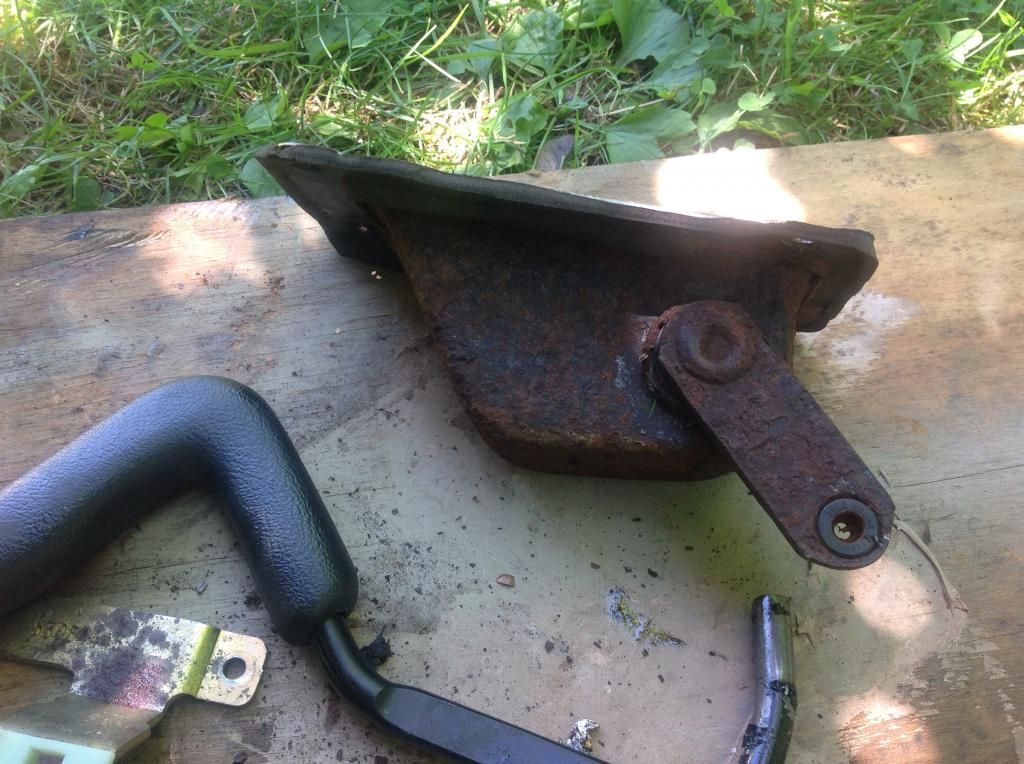

My transfer case shifter would not go into 4lo so I knew I had to rebuild the linkage. I could manually shift it at the t-case So I knew that the linkage was the problem. I went to the junkyard and pulled a fairly good condition linkage and tc skid. I also ordered crown's rebuild kit for the linkage. I cleaned everything up and por-15'd it I pulled my shifter and the tab was rust welded to the housing After some persuasion I got it off and cleaned up There's a hole in the floor
The old and new linkage I put everything back together and greased the crap out of it . After some tweaking, it shifts like butter
