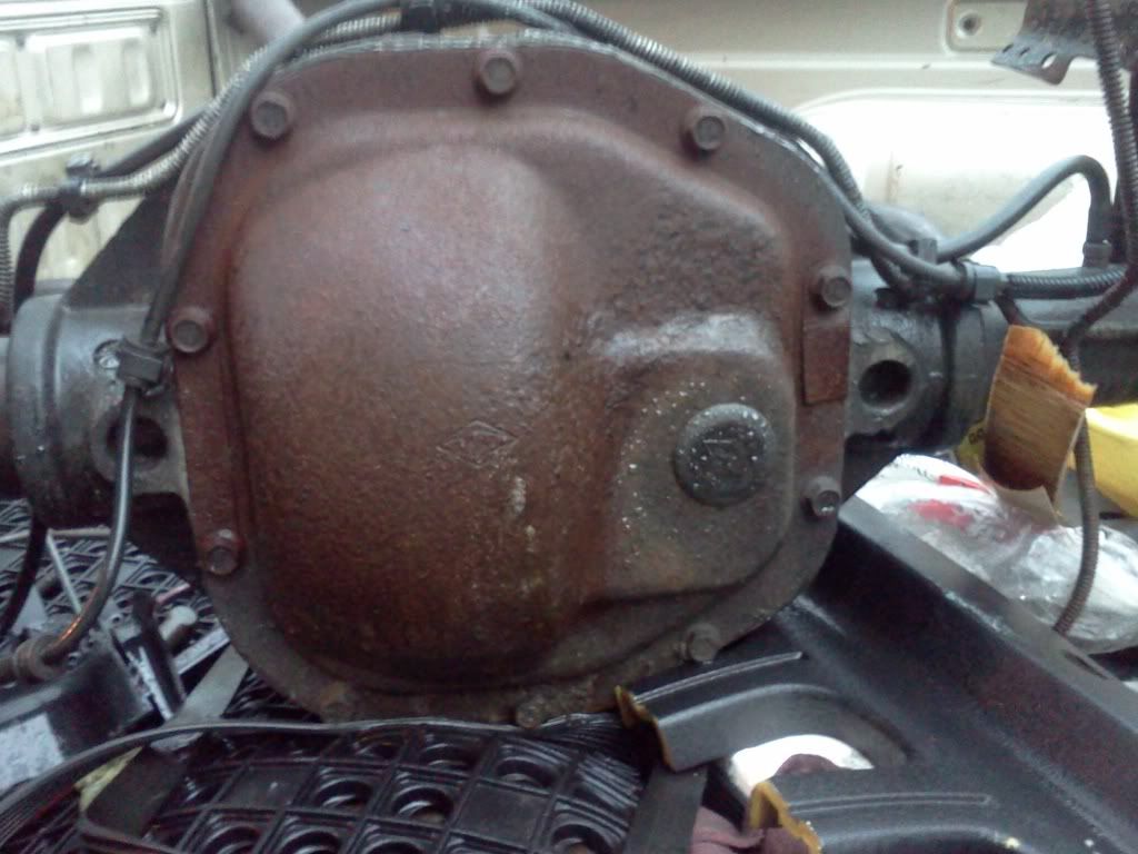

your 5.9 44a has a Limited slip carrier in it now the aussie/any locker for that matter will not fit in a limited slip carrier.
a carrier is
open on left. LSD on right
