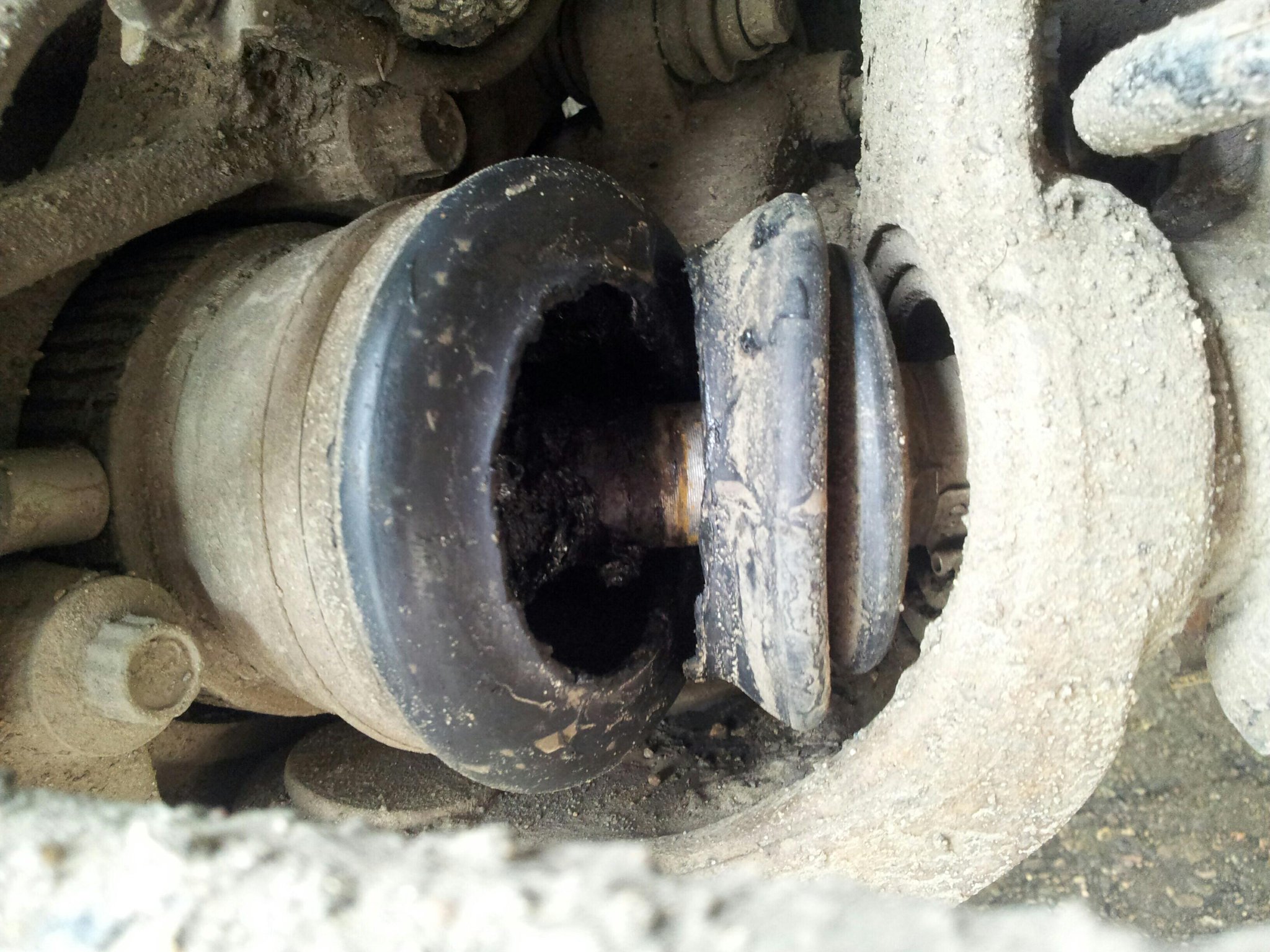

One of my CV's let go on me yesterday. I wasn't even wheeling either, just turning to back into my parking spot :'(
Luckily, I got it on camera (in jeep cam)

After pulling myself together I decided to go see what kind of scraps I could find and what it looked like underneath
It's a 96 ZJ limited. Would anyone be able to tell me if I'm going to find C-clips, or will I just be able to slide the axle shaft out?

mine didn't have a c-clip...pop the wheel, brake assembly and hub off and slid the shaft right out....heard that some do/passenger side (mine was on the drive side) but Idk for sure.

Just a friendly reminded, don't drive it til you at least see if you can pull the shaft (seriously pull the hub and if the shaft doesn't come out with relative ease, well someone else is gonna have to chime in). Don't wnat to mess up the spider gears or anything.

It's pretty easy to swap the cv shaft.
Pop the wheel off, pull the caliper off the knuckle (2x13mm bolts), pull the rotor off (falls off after the caliper is off), pull the cv shaft nut (35 or 36mm, factory is 36 but many aftermarket are 35), pull the three hub bolts (funny 12pt heads), may have to pull the abs sensor to get the shaft out, but it just pulls out.
Be careful putting the new shaft in not to damage the oil seals at the diff.
Reverse puts it back together. Knuckle to hub bolts get 75 ft lbs, axle nut gets 175 ft lbs.
