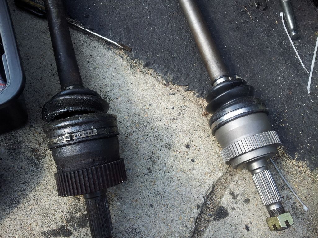

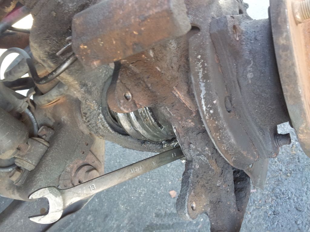

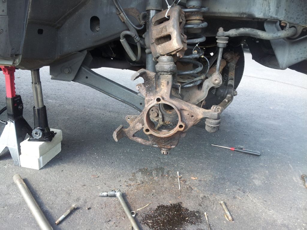

Good thing i weigh close to 300lbs.. Jumping up and down on my 28 inch breaker bar for like 5 minutes broke the axle nut loose lol. If you think that this part is hard.. Imagine trying to remove a rusted on wheel bearing ? You live in Cali so you might not have rust problems.. Me on the other hand lol i got all 3 bolts out fairly easily but the wheel bearing was like welded on from rust and time... What I did was buy 2 cheap bolts threaded them in part way and bang the ends with a big hammer and eventually it pushed the bearing out..
Make sure you properly torque the axle nut back on, i believe its suppose to be 175ft lbs or something
Some pics of when i did mine last year, notice the torn boot and rust shavings all over the ground haha
