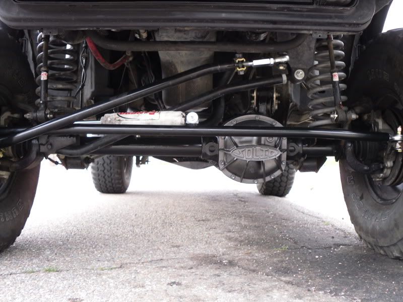

i also have the Iron Rock Offroad setup
heres mine
Matt
