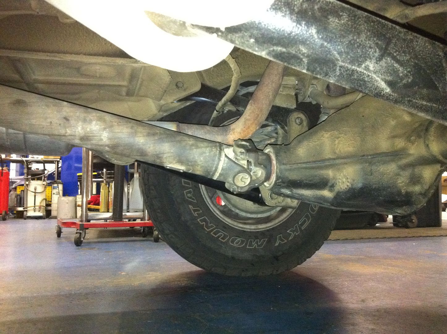

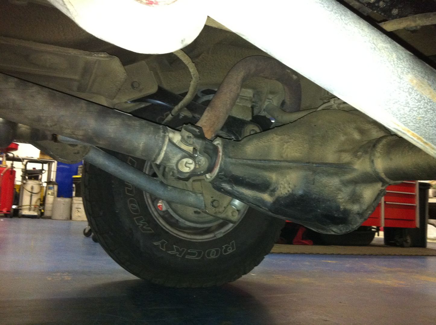

i jinxed myself. i swapped out the front and rear poly bushed procomp lowers tonight in favor of some RC units with the clevite bushings. the rears are at least 1" if not close to 2" longer than the procomp units which turned my rear pinion angle to ****. 30mph and up its nearly undrivable it vibrates so bad. with the procomp arms, the pinion pointed in nearly the same angle as the driveshaft and actually caused the driveshaft to be pushed into the t-case all the way. with the RC arms, there is quite a bit of slip yoke visible and im concerned that if i try to correct it with adjustable uppers, my driveshaft will be pulled out even further and possibly fall out when the suspension is compressed.
im almost certain that you have the same issue since you are running the 3.5" kit which has the same lowers as i bought. i have an email into mitch in the technical dept at RC for suggestions. have a feeling im going to be looking at adjustable lowers instead....

trust me, i know the pinion shouldnt point inline with the shaft but for whatever reason, it worked fine with that setup. 70+ on the freeways no problem. now with the current angles, not working! im going to drop the t-case an inch or so to see what it does, not holding my breath tho.
when building my brothers s10 jimmy with a dana 30 swap, we did a flip kit in the rear and had to set the pinion angle the same as the t-case output
1993 Jeep ZJ Laredo 4.0L/42RE/242/D30/D35

put the rear lower procomp arms back in, all vibes gone. looks like ill be looking for some adjustable uppers now.
sorry for the thread jack OP, but im certain the source of your vibes is the rear axle pinion angle. get some adjustable rear upper arms so you can dial in the pinion angle and the vibes will be gone and there will be no need for the t-case drop = more ground clearance
