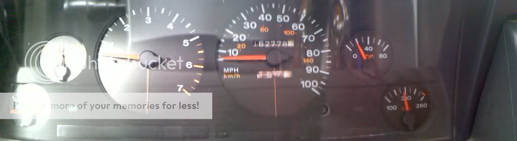

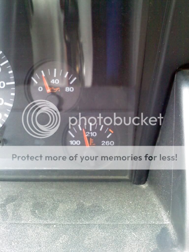

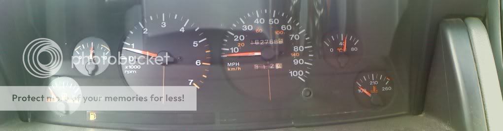

i checked the oil level and its full. i did take a couple more pics (sorry if they are a little too big) of my idle when the engine is cold and when it has run for a bit to get to operating temperature...
cold:
warm:
these are cellphone pics so sorry about the quality. i'm going to check the IAC as soon as i find some tools. i dont have much with me in laramie right now

looks like someone just emptied their wallet into their gas tank! The temp looks good to me now, but the oil pressure does seem a little low at idle. does it increase when you are excelerating?

lol, yeah i did...when i accelerate the oil pressure does increase, its only that low at idle. i pulled the iac out earlier and it was a bit dirty so i cleaned it...idles really weird now. it was nearly at 0 for a bit, so i drove around and it went up, but it still seems low. sits at about 500rpm, maybe a little lower now. i'm also planning to go get it scanned for some codes tomorrow just to see if there are any
i just talked to my dad and he said about 5 years ago we took it into the mechanic we used to bring it to (not so much anymore) and they adjusted the idle to be lower at about 500 rpms, where its sitting now. i'm going to look for a shop somewhere near me that knows what they're doing and have them adjust it to where it should be. hopefully that will fix it.

Thanks for the pics. All your gauges are on the money when cold. Your oil pressure and temperature gauge worry me a bit. I've never seen mine go up that high before and I live in sunny Florida. Could it be you have air in the coolant? The oil pressure is still a tick too low but it shows that it does elevate past 40 psi when cold.
Your idle speed should be between 750-800 RPM. Could be slightly higher when it's cold. Where idle speed indicator is at when the engine is cold is where your idle should be when it's warm or just under that tick mark.
One thing that is definitely okay is your fuel gauge. Shows exactly where most Jeep owners' wallet capacity is at. EMPTY...
