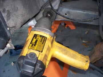

First thing was to get the hub nuts loose on the ground before I put the jeep on stands. 36mm socket and a small bar. This was weirdly easy and I don't think they were torqued to 175 or had gotten loose somehow. I then put the jeep on stands. Chocked the rear wheels and put the Ebrake on. I had mistakenly got the 12 ton stands at HF, so my jack with a block would only get the jeep on the first level of the stands. Put them behind the lower arm frame mounts.
