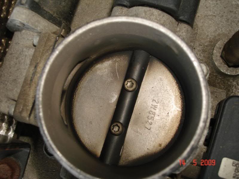

Just got an Amsoil Dry Filter Works better no Oil
My K&N i had made my Throttle body sticky as hell.
K&N after about 6k miles.

^ looks like normal carbon build up in the TB. K&N filters suck though.
@JonM81. That design is worse than stock.The engine can more easily suck in air, but it's all coming from the engine compartment which will be very hot.

may be but it was sticky not a dust it didn't wipe off easy had to use a tooth brush.
x2 you allowed it to suck air from the Headers now
