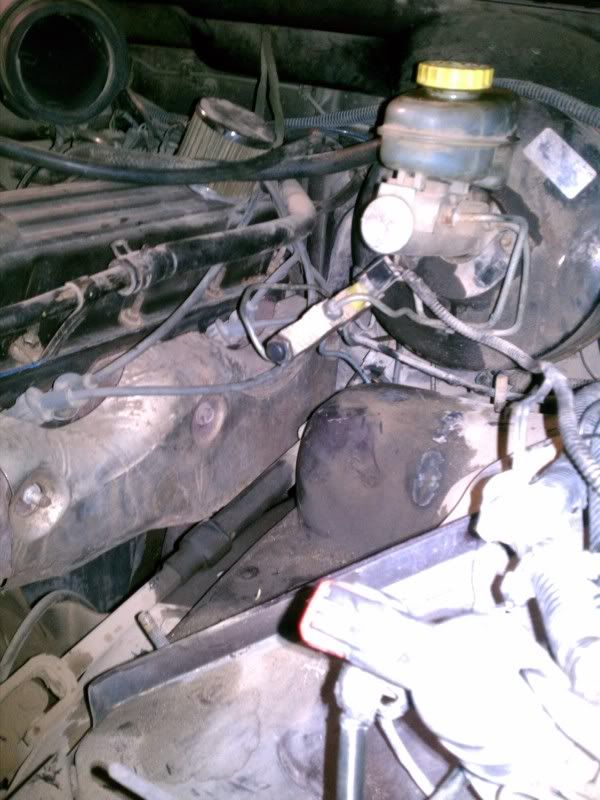

Got it all taken off and hooked back up straight from the brake booster to prop valve... tested and brakes great!!
Here are the parts i used from O'reilys auto parts to make the rear brake line fit into the rear hole that is plugged up on the prop valve.
All you need is a pipe cutter,flare tool the adapter parts above and some time.

Posts: 2,890
Excellent.
When you unplug the covered port on the prop valve, does fluid leak out?
I'm just trying to picture this before I do it.

Thanks, there is no fluid that leaks out when you take the piece out, fluid leaks out a little bit when you remove the lines from the prop valve but very little.
