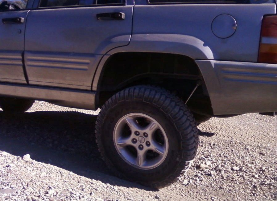

here is the pics
fronts
Rears
and i have never had any problems

here is the pics
Good flex?
