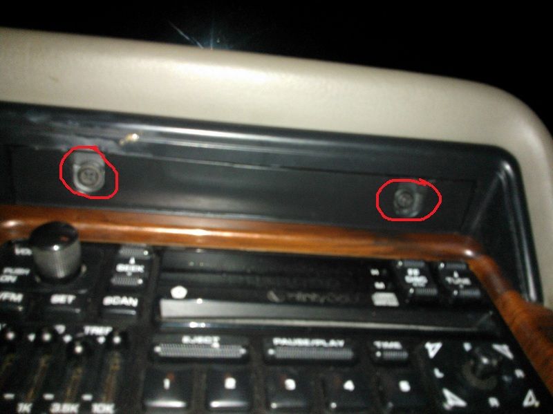

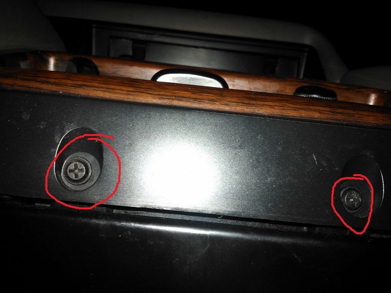

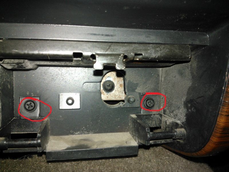

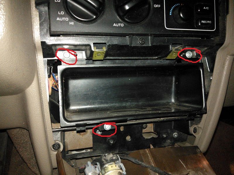

::::::: Mod Name:VIC removal and repacement
::::::: Why Worth It: get rid of annoying beeping/incorrect error messages
::::::: Cost: <$10
::::::: Where to buy: junkyard
::::::: Time required:~15 minutes
::::::: Difficulty: 2/10
::::::: DIY: Go to JY and find 2wd ZJ. In the place of a VIC, there is a cubby box. to remove it, you need a phillips screwdriver. there are 2 screws upbove the radio, 2 screws above the cubby/VIC hole, and 2 behind the ashtray (for 93-95 ZJ, im not sure if newer ones are different). pull the dash panel out. 3 screws hold the cubby box in, 2 on top and 1 on the bottom left. pull the cubby box out and buy it. remove your VIC following the instructions above, and install the cubby box in its place. reassemble.
::::::: Picture(s):
