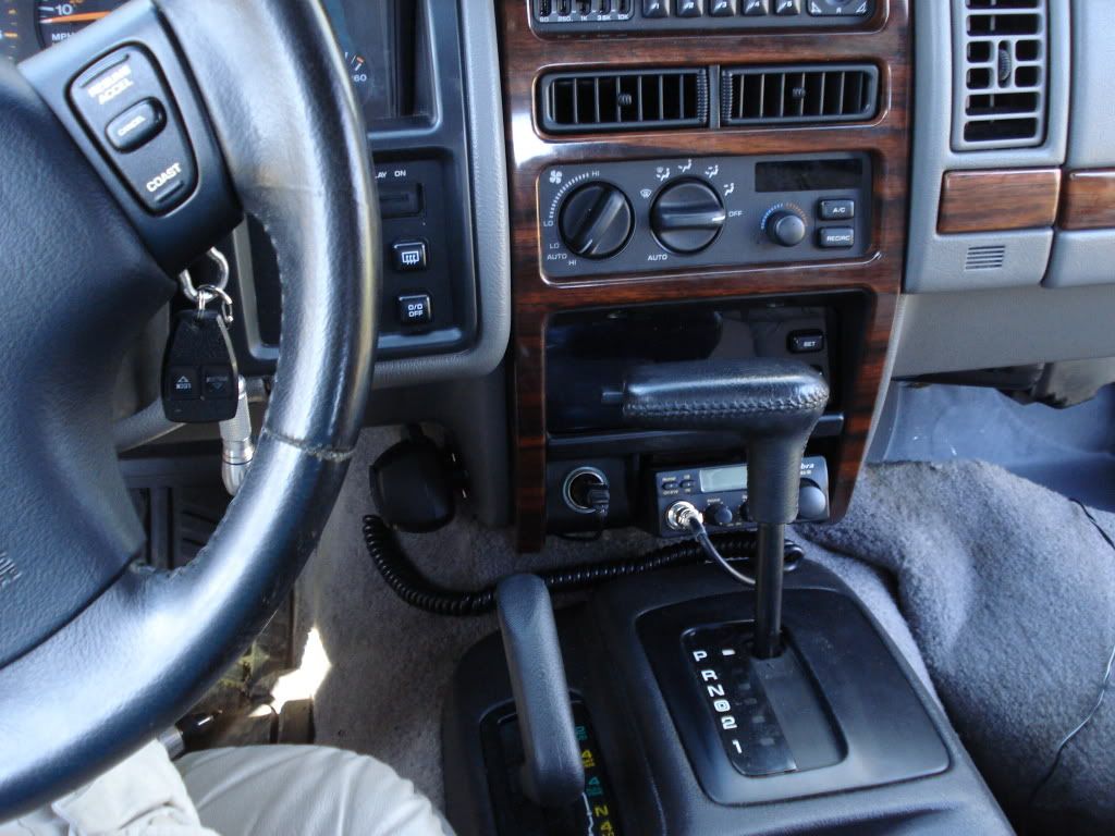

I kicked my VIC in the dick and made a cubby instead. My CB is to the left of the steering wheel and gets bashed in with my knee quite often
Build thread^^

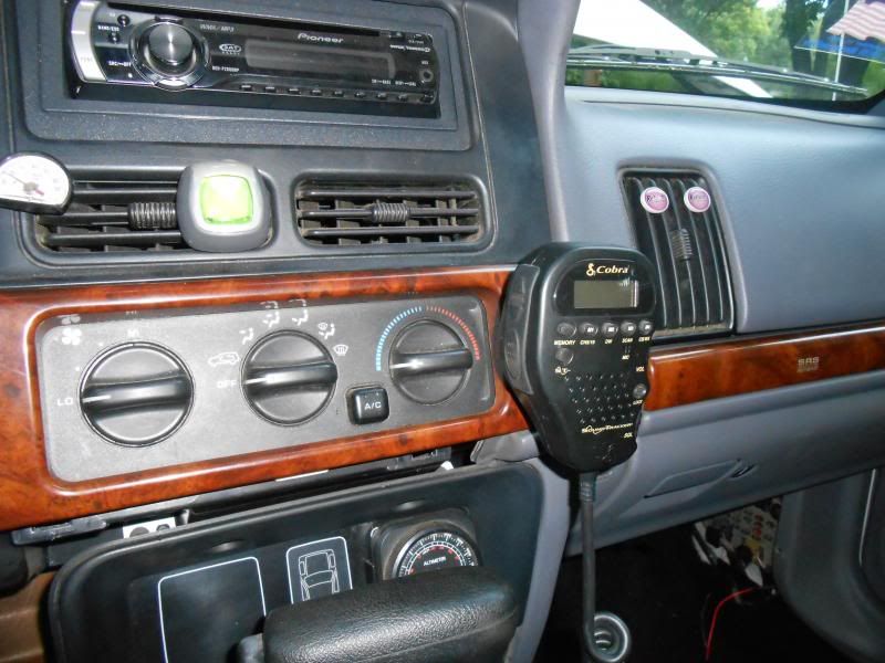

Most CB's dont fit in the space the vic leaves which is why people do the climate control swap. The swap is easy if you have the (all electronic) ATC climate stuff as in the picture. Not so much if you have the manual controls as they are mechanically linked to pieces of the system.
It's really a shame nobody makes a remote head CB like all the ham gear is, makes it real easy to put the body of the radio under the seat and the control head where you want it.
