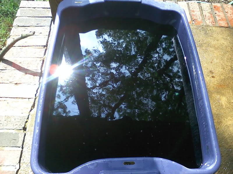

MineRunner... how long did you leave the carpet submerged in the water/dye?
Was wrenching on a buds Scrambler yesterday, i ended up bringing his carpet home as well, his is dyeing now. Figured i'd let it sit overnight then take it out and hang dry.
Picked up 6 8oz bottles of black for his carpet. His has less of a pile on his carpet so i figured it'd be a good test prior to doing mine.
Sitting in the dye and HOT water solution, tomorrow i'll take it out and hang to dry. Then rinse with cool water and let dry again.
ExpeditionXJ is offline
post #14 of 19 Old 05-16-2011, 08:54 AM Thread Starter
ExpeditionXJ
Location: Bristol,PA
Posts: 588
20 hours soaking, looks like this works well. Remember this is a Scrambler carpet i'm doing a test run on. Think i need a larger tote for the ZJ's carpet.

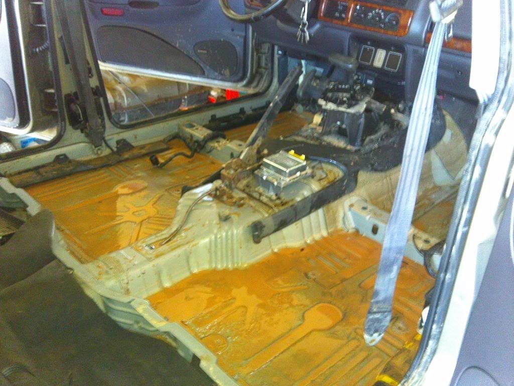

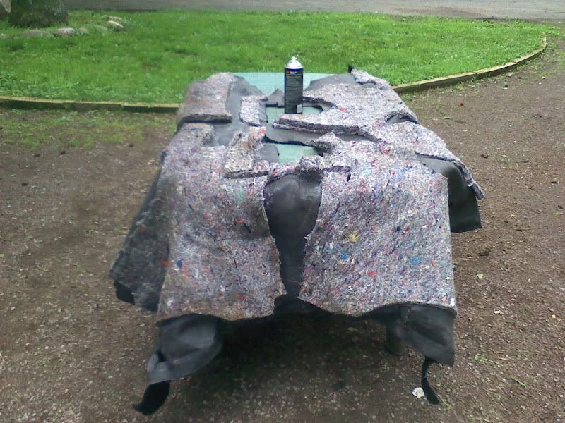

Mine is done, had to go pick up a larger 45 gallon tote to do this in. I'm very happy with the results.
First i rinsed out the sound deadener/insulation i removed, let it dry and used 3M adhesive to reglue it on.
