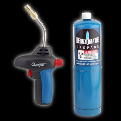

Heat and beat, your trashing them anyways right.
