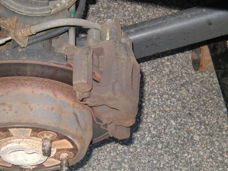

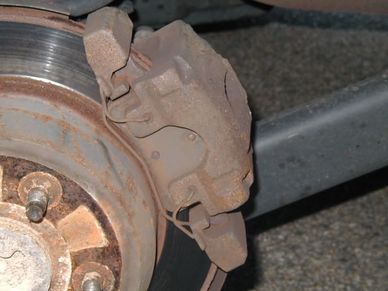

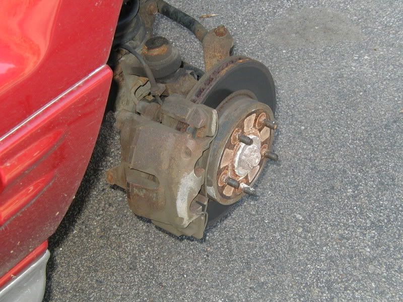

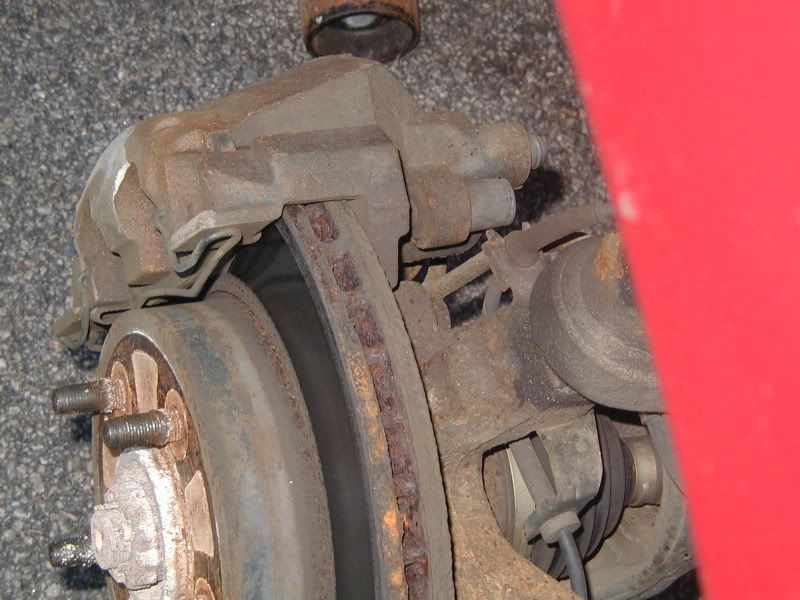

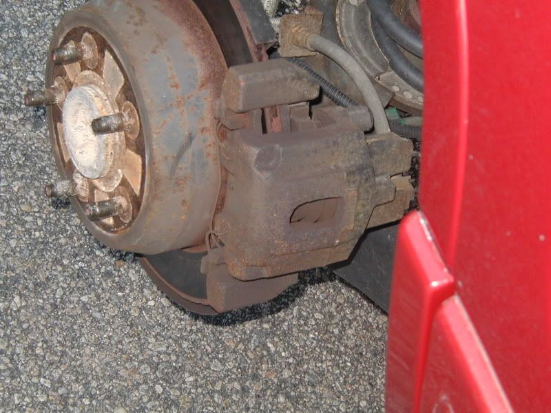

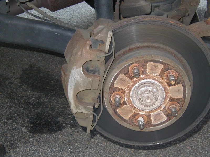

Thanks for the help there guys. Here are some pics let me know which ones they are. If they are Teves, is it worth the switch to akebono if the jeep hasn't had any braking issues yet?
front:
rear:
I think these are TEVES what do you think?
Edit: When they switched to akebono, did they just upgrade the front calipers or all around?

post #8 of 9 Old 08-16-2009, 11:20 AM
gatorayde
Location: Crystal Lake, IL
Posts: 3,331
Yep, those are teves. They only switched the fronts to akebono. If they aren't warping rotors right now, it's up to you if you want to switch. I would recommend switching to akebono's after I had to pay ~$800 to get everything done right (~$300 for stillen rotors/pads which warped and then $500 for new rotors, pads, and calipers).
