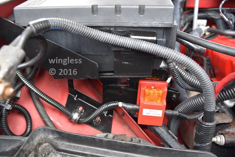

Here is an early installation version of my Blaupunkt GTA470 4x100W RMS DSP amplifier w/ Scosche SLC-4 impedance matching transformer that connects to my factory Infinity Gold head unit. This shows some of the Dynamat, the decoupler and the mass loaded vinyl that was part of my installation.
The wiring harness was disassembled, rerouted and labeled for the installation. It was not required to splice cables to increase the length.
The Blue Sea 5006 amplifier Maxi fuse block is also shown.
The existing Infinity Gold amplifier cable ends that were cut off and labeled are shown.
