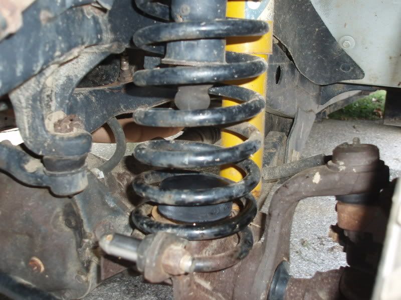

Do I ABSOLUTELY have to take off the coil to get the bumpstop installed?
I put the lift on already and today noticed that my driver side DOES NOT even have a bumpstop just the metal housing that the bumpstop sits in...
IDK if it fell out? never had one in there and never noticed? or what... but I would really hate to take out the coil and jack it all up to install the bumpstop..
Can I just squeeze it through the coils?
Also it won't F anything up if I run without a bumpstop on that side till I install on right? as long as I'm not flexing or doing any offroading?
Mainly to and from work on highway

You'll be fine until you do something that should have hit a bumpstop and you shear or crush something else.
I hit the stock bumpstops coming out of parking lots all the time, they're there for a reason.
I'm pretty sure you need to at least droop the axle so the coils are loose to put a new stop in, it's not like its hard to pull the coils so why try doing it the hard way?

Throw some hockey pucks in there....problem solved. You should be able to push them between the coils with it flexed out.

Yeah the passenger side still has to stock bumpstop but the driver side doesn't have anything ha, I think Ill just jack it up and flex the coil and squeeze it through the coil...
and if I end up crushing my fenders before I get the bump stop replaced lol guess that just gives me an excuse to trim the fenders an inch or so ha
Should I just get stock bumpstops? Or with a 4" lift should I get new ones that are extended an extra inch or so?

No, not coil spacers, actual hockey pucks. Rtv them to the coil perch inside the coil.

no ****! haha I would have NEVER thought about actually doing that...
Thanks bud! Now going to go find some hockey pucks lol

You will be amazed at what the dealer charges for the OEM bumpstops. I replaced mine several years ago and it was $80 for the bumpstops and the metal cups (which were rusted beyond use.)
