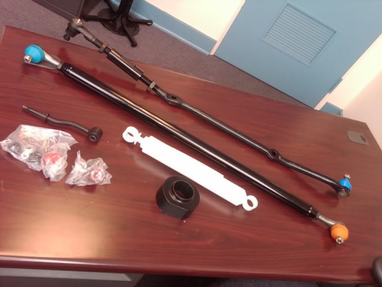

I just ordered all the parts for my mechanic to install in 2 weeks while I'm away for the week. Hope it goes in smoothly, he's more used to working on sporty foreign cars lol
Rusty's:
2" BB with shocks $200 (couldn't resist... hopefully won't ride too hard)
Complete steering kit: HD tie rod, drag link, sleeve and all new ends $220
"Old style" ZJ sway bar links and hardware $35
new sway bar link mounts $29
with $55 shipping, total $542
Rockauto:
Centric Premium Brake rotors $64
Centric HiPo pads: $54
Almost ordered 4 new control arms, but the bushings didn't look too bad so will save this for later.
Will post pics when she's done!

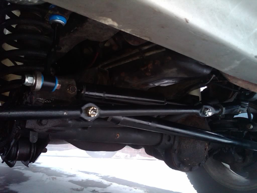

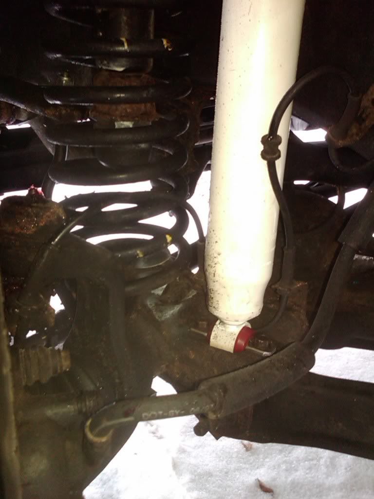

Before leaving for a business trip last week dropped the 5.9 off to have all the goodies installed. The anticipation on the way to pick her up this morning was fun
So far she feels great. The Rusty's shocks ($200 incl BB) feel a little bouncier than before (I think they were Monroes), but not bad at all overall.
My mechanic called the ever helpful Zak at Rusty's to confirm the rear BB pucks needed trimming, which he did with a sawzall. He removed the old, broken SB mounts with a cutting torch and welded on the replacements from Rusty's with a MIG.
Said everything went in easily enough, but for alignment the tie rod and drag link were almost too long i.e. close to being not enough adjustment 'in'.
I'm suprised about this - unless you're lifting WAY up high I can't imagine that these parts would need to be much longer (and then you'd install a dropped pitman arm right?).
Anyway, it drives fine, especially since the last time I drove her was without any front sway bar :P
Total cost:
parts as listed above: ~$660
grade 8 nuts/bolts for shocks and SB links from ACE: $15
Installation (sway bar axle mounts, links, new steering stabilizer, tie rod and drag link, shocks, BB, front brakes, alignment, oil change): $512

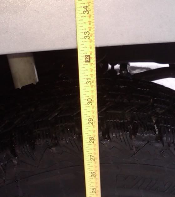

Height from ground to fender lip
before: 31 1/4"
after: 32 1/2"
Thanks for the advice all, especially NewfieZJ for pointing me towards Rusty's for the SB axle mounts!
Rusty's goodies
front parts
front shock
rear BB
after
she grew a bit!

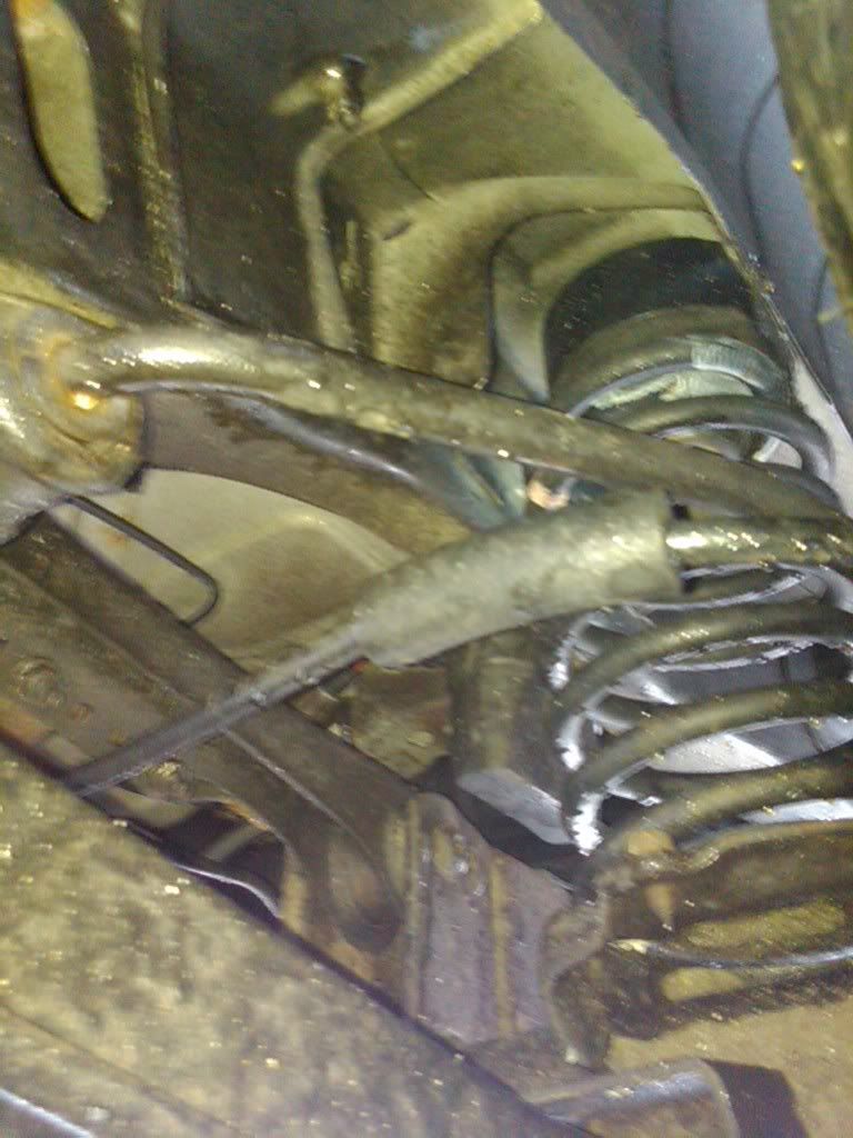

Same thing on my 98 5.9
