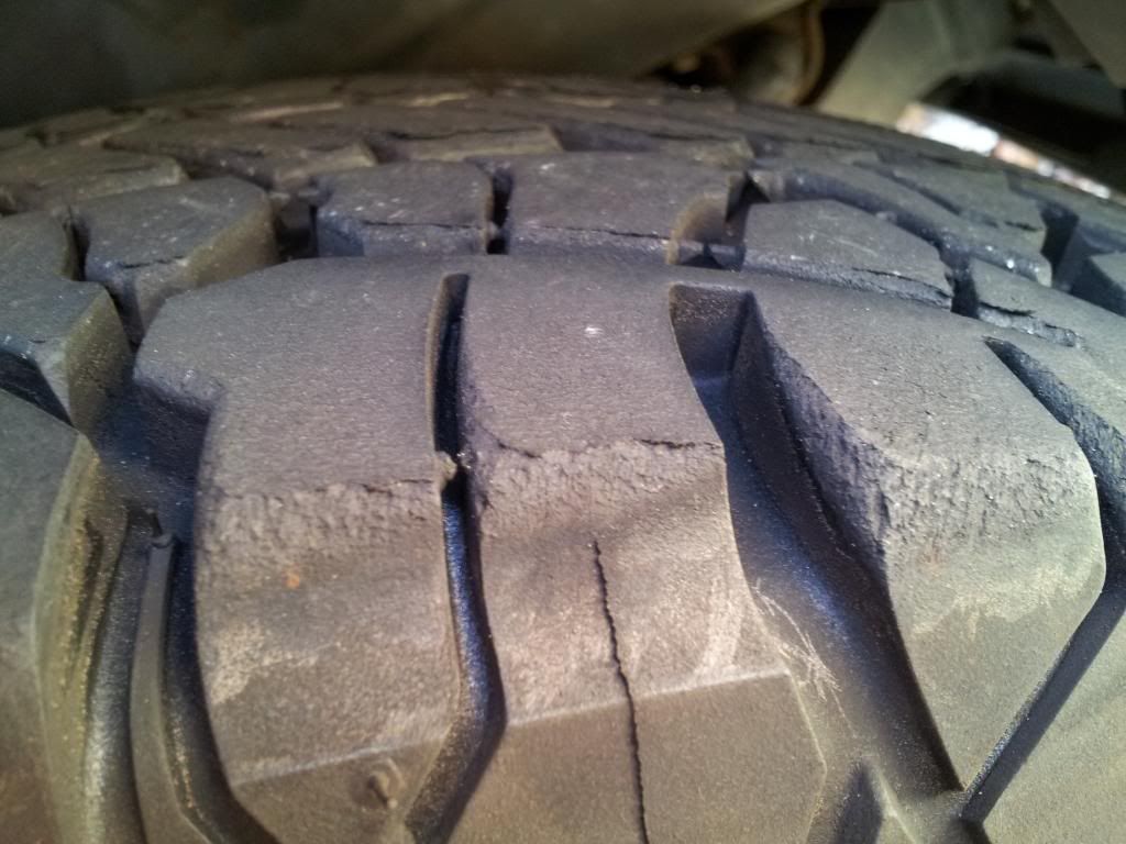

Here is another picture of that tire... Look how horrible that is after 2-300 miles.. Notice the outside how shredded it is.. then look at the tread on the rest of the tire.. its got rubber peeling off
all over the tread

My issue is pretty much fixed, the horrible picture you see up top it hasnt done that since the like 6 th alignment i got actually corrected my issue.. I do have some slight wear on the outside on the passenger side vs the drivers side, but then I do make alot of high speed left hand turns (stop lights ect) so thats a given i believe.. Im just rotating my tires every 2-3k miles to keep the wearing even.
