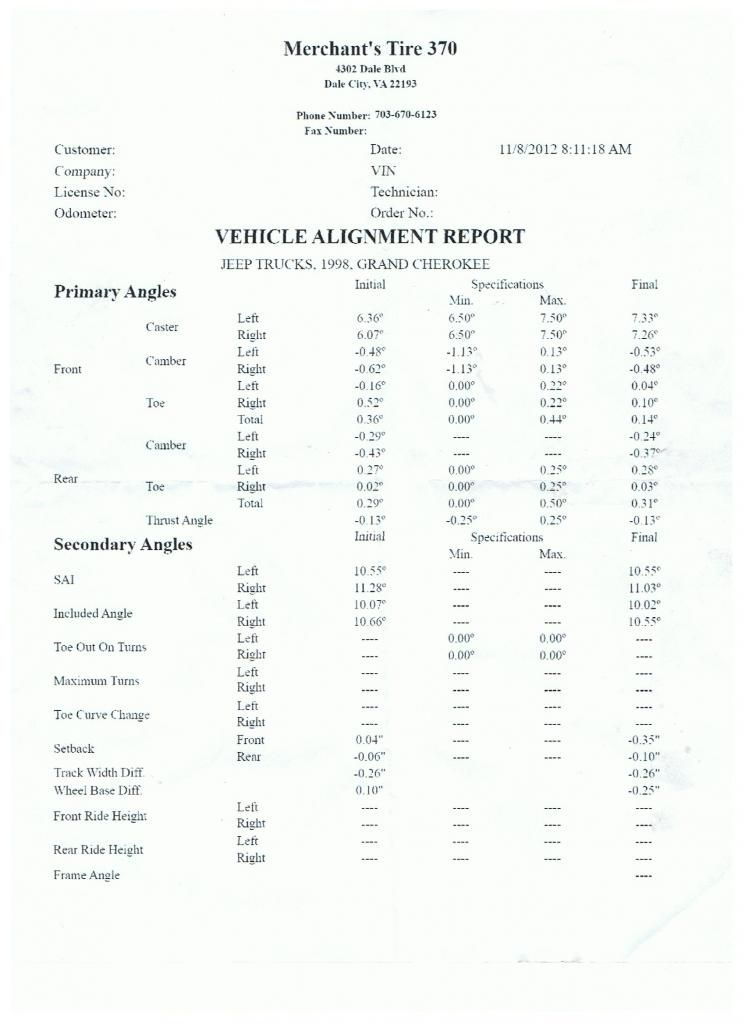

Yea the place that chart is from said my drivers rear toe was off.. Said it could be from a bent hub or something.. If they are suppose to adjust the front via the rear then why the **** arent they doing that !!!
Setting the front toe by referencing the back tires doesn't mean you can compensate for rear tires that are out of whack. And since the rear of a ZJ is not adjustable, I'd be looking real hard at what's happening with the rear axle now. Including checking the wheels for a smidge of runout/bend that's gonna skew the alignment rack setup
I'd also take it back and have them center the steering wheel. Any alignment tech that doesn't drive their own work is a retard.
FWIW I had something similar happen with the first car I ever clipped/stubbed. Darn wheel positions ended up in a parallelogram pattern when viewed from the top and no amount of adjustment ever cured the weird tire wear. It drove straight as an arrow but would scrub a tire edge smooth in 6k miles.

Can you explain what is out of whack at back by these numbers tho ?? Because I dont have any road noise from the rear or anything.. So i honestly dont know what the problem could be... Im going back tomorrow and im going to have them look at it once again... and your right im telling the idiot to drive the Jeep first and after so he can see what im talking about as far as my steering being off center so badly.. Because now that I think about it none of these guys actually test drove my Jeep. I know how to adjust it myself, by unclamping that bar up top and turn it to move the steering wheel, but wouldnt that knock the toe out ?
Im about to give up on merchants tho, only reason why i've been to 3 of them so many times is because i spent an extra $20 for a year free alignments... but they just cant seem to get this **** right..

Originally Posted by Candymancan View Post
Its been on 3 different racks, about 5 times now... I went to another Merchants today, they checked the alingment and had the master mechanic look at it while on a lift, he poke and proded my joints with a pry bar, checked for loose parts he said my steering and suspension is in good shape...
The adjustments the prior shop was good, cept he said the toe was a little off.. it was 0.03, they adjusted it to 0.14. The steering alingment was way off all the way on the left of the red bar.. It was like 0.34 degree's or something like that.. He adjusted it to 0.02.. I took it home and all that did was make it worse... Now my steering is like a good 2-3 inches to the left and its hard to drive the Jeep and keep it center..
This is pissing me off..
Here is the alingment chart from the shop i went too the other day, prior to today.. All the specs are the same, cept the toe is now 0.14 instead of 0.03 and 0.10
like was alluded to earlier. there's a few things going on with the rear that aren't good. and aren't really fixable.
for one. your toe and camber are off compared to what you'd expect on a rear live axle. it should be within a few hundredths of zero for both. worn out wheel bearings or a bent axle or bent wheel accounts for that.
next.
i see the wheel base and track width are off side/side front/back
this isn't lifted? i think your fender bender was a little worse than you may have thought. you've got dog tracking and pushing and it seems the axles are out of whack where the standard alignment can't do anything with it.
your front right toe was absolutely horrible when you got there. normally that means worn out components or terrible thrust angle.
what is meant by adjusting the front by the rear is that the rear is supposed to be the fixed location on these. nothing is adjustable. even though they use that as the base line, if it's off you'll just keep getting terrible alignments that are "good by the numbers"
these mechanics are going by the machine, fixing this is beyond the scope of a standard 50$ alignment.

Find out what is wrong with the rear end,something is bent and /or worn.Going to happen you got the mileage you have.While the thrust angle is not that bad it does show the rear axle is not centered under the Jeep.
The only way to change the SAI is by changing the camber and that will require adjustable balljoints to be installed in your Jeep.SAI is also better known as "scrub radius".
Oh and get that caster back down to the 6.5 degree mark,your running way to much caster.Five-six degrees would be much better no matter what the OE specs are.

The rear shouldn't have toe in or out. The wheels should be parallel.
Now if you have a bent wheel or axle flange, an alignment machine can detect that as toe in or out depending on how the bend is positioned. But to actually create the a toe change that's real, you're talking bent or improperly manufactured axle housing.
What you need is an alignment rack that's associated with a collision shop, not a high volume tie rod replacer shop. A collision alignment tech will be familiar with cases like yours. But if the axle's bent, not much he can do, all you're gonna get is a competent answer.
You might try string lining the back tires if you've got extra time on your hands. Otherwise it probably needs to go on somebody else's rack to confirm the rear diagnosis.
Might also be able to see unusual wear on the brakes or axle's bearing surface if it really is bent.
FWIW a single bad bushing in the rear suspension can create a shift under turning or braking that isn't detectable on a stationary alignment rack.
next.
Well, The fender bender I was in was earlier this year.. I got hit on the front right corner it actually broke a wheel stud off on that side which I had to replace... Thats side that is wearing like this... The thing about that tho is my outer tire wear was happening way before that accident.. So i dunno.. If my rear axle is messed up, then I dunno what to do.. I cant afford to fix that so its either just keep driving it like this.. and replace my tires every 20-30k miles or fix it.. : /
To answer your question about being lifted. No it isnt lifted.. I measure 18 inches from center of the rim to the fender on both sides of the front, and 18 1/2 on both sides of the rear. I think it was closer to 19 when I had the smaller tires on
This is a pic of the dmg to my front, but like I said my wearing on the outside tires was before this accident.. You can look at my tire and sorta see that its nearly bald
http://i1083.photobucket.com/albums/...2/IMAG0273.jpg
So what should I do then ? Should I go to a body shop and have them check my body to see if its ok ? Would they be able to check the rear axle and everything your talking about to see what the hell is going on ? I can see it now this is going to cost houndreds to diagnose at a body shop.. What is string linging the back tires ? Can you explain ? I'll go on google and look it up for now..

a hit hard enough to break a stud definitely did some axle damage. i think it's showing up in that absolutely terrible toe you had. i bet the toe is off again the at the next shop.

I'm with Rat on the hit. You may have a tweaked spindle or axle housing and probably a smidge of bend on a trailing arm tab. A dana 30 isn't particularly beefy. Could also have something going on with a ball joint that's not detectable without disassembly.
You run into that kind of problem dealing with hits. Sometimes you just gotta take the leap of faith to tear it apart to know.
