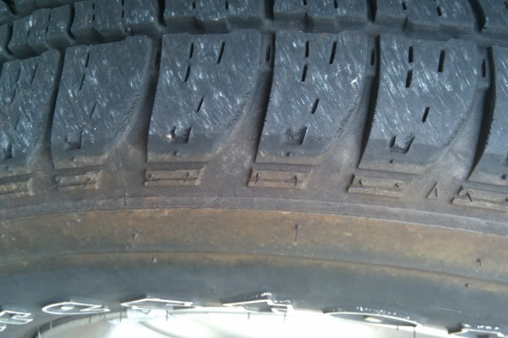

I'll take a picture when my mom gets backs home from work she is borrowing my Jeep.. This is my old tire tho on the outside edge.. As you can see obviously the tire has some decent tread left.. Maybe 6-8k miles after this picture was taken.. the tires even with rotation's were so bald right there, that there was litterally no tread left on the outside lugs.

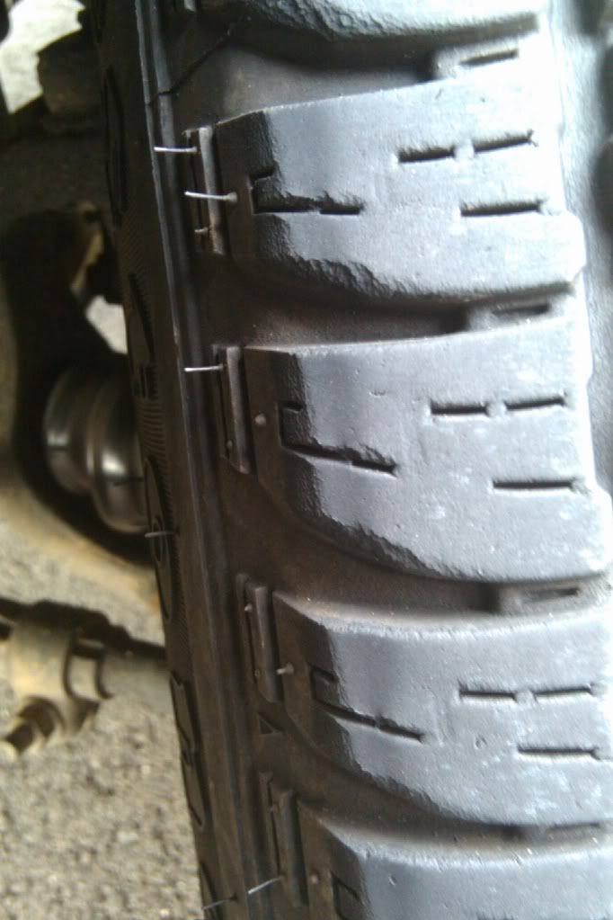

This is the inside of the that tire taken at the same day look how much tread is left.. Its like double the thickness.. and after i got rid of these tires.. when the outside had nothing left.. The inside had about what the first picture looks like.. It was nearly down to the wear mark but still decent tread left..

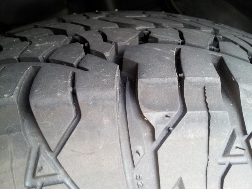

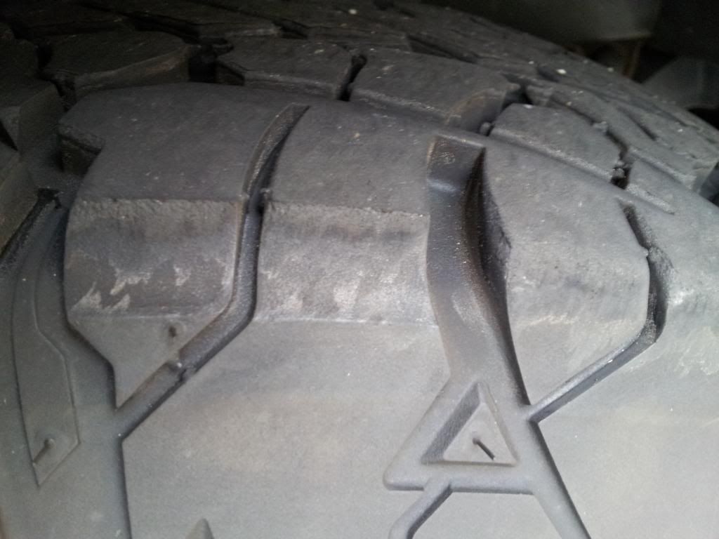

Here look at my tires... This is with 200 miles on them.. Note how the first picture which is the drivers side. Is wearing smoothly.. Then note the 2nd picture the passenger side how its all scrubbed and rough and missing tiny bits of rubber on the outer edges of the tread... That doesnt look normal to me for 200 miles..
Expand the image to see it better.. You'll notice the diff between the 2 tires right away... One is smooth, the other is rough, missing corners of the tread already.. Looks terrible compared to the other side.. The other problem is outa those 200 ish miles i drove 120 were on the freeway last night... So no sharp fast hard turns. just straight driving at 65mph... Something is wearing out my tire on that side, and im wondering if its related to the off center steering.
