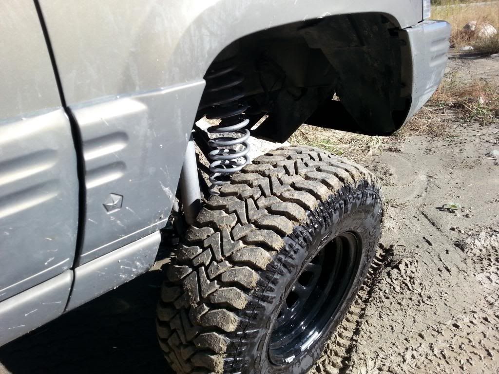

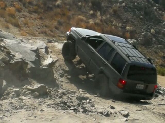

i'll save you teh wait. if he tries to flex it out on something bigger than a curb he's going to cut those pretty tires up and most likely rip the bumper off.
what tire fits' is relative to what you're building. if flexing less than an IFS truck is all you need then you can sure pop some fat tires on it. if you want it all flexy and stuff then you're not doing much more than a 33, with a bit of trimming.
again, thats all relative to what you think is 'flex'
nope, wrong. i am already cut, rolled and trimmed, i already added 4" of bump stop for the rear and the front will end up around 4" as well. sorry to disappoint, no bumpers will be ripped off or tires cut

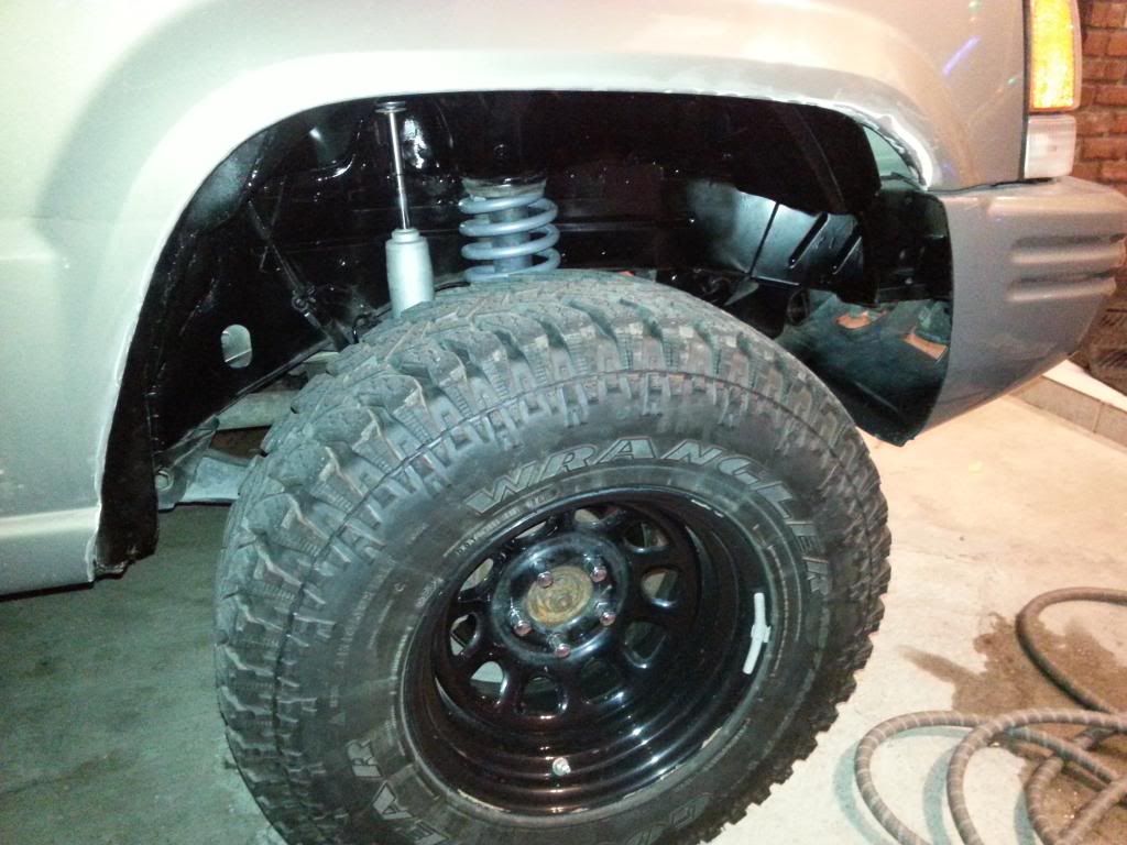

hey shock, yup they are 12.50s. control arms will give you a lot more droop than the stockers, so that will help in the articulation department. here are some flex shots wearing the 31s I just traded for the 33s. i had it to where i could turn lock to lock stuffed to the bump-stop, will have to do a little trial and error with the new shoes but i am cool with that. i am going long arm in the near future, but the rig does good, really good for running oem arms.
it was cool wheelin with the 31s, but it is going to be a lot nicer with all that clearance under the pigs with the 33s.

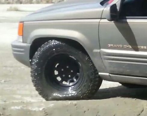

Im throw in a flag on this one. Maybe before you bump stopped? No way yo go lock to lock like that. I had more lift and bump stop and bent the fender out about 3" with the tire.

i am surprised you could not tell that the fenders were not cut in the pic you referenced, and you even have over 3K posts, what's wrong with this picture?
um, after i cut the front fenders, the pic you referenced was R&D before bump stop and cut, see below for the end product, you can pick up your flag.

you posted a pic talking about going lock to lock at full bump at a point in your build where in said picture, you couldn't
