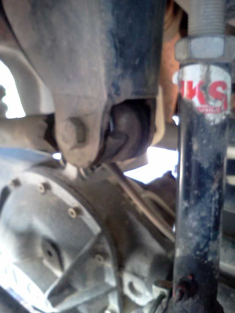

I installed new bushings in the TB and first trip out they are shredded. I'm tired of blowing trac bar bushings on my IRO Adjustable Double Shear Track Bar. Whats a better set up?

I don't understand how you can be shredding bushings like that. My Rubicon Express Extreme Duty track bar has a flex joint at the frame side and the original bushing at the axle side.
I've wheeled the crap out of it for years and when I tore the suspension down for inspection this spring the bushing looked as good as new.

I have wallowed out the axle side bushing before but never this
Im see clayton uses a flex joint on the body side. Would that fit in the iro bracket horizonally?

Originally Posted by Showtime3492 View Post
http://www.ironman4x4fab.com/Products/TB.html
exact one i have. Its freakin beef
Except the IRO bracket is a heck of a lot beefier. Their "double shear kit" won't solve the weakness of the factory bracket.
I might have to order some spare bushings now that I see it could be an issue.
The ironman4x4fab bracket is just as strong if not stronger. Yes it is a factory bracket re drilled and a double shear end welded into it but those factory brackets are more than strong enough to handle it.

The Ironman Fab is a piece that bolts onto the factory bracket, IRO replaces the stamped factory bracket with plate.
http://www.ironman4x4fab.com/Products/images/STD_FTB.JPG
The factory bracket is slightly thinner but it is stamped with bends and ribs in it that strengthen it then i has a sleeve welded inside it the further strengthens it. The weakest point of either bracket is what it is bolted to and the "peel" effect
I own one. In talking to Andy from ironman4x4fab he recommends welding them in place although bolting is fine.
