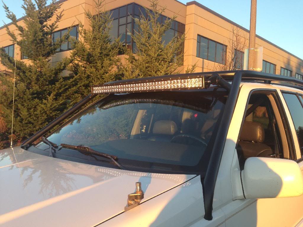

Its not the most economical light but I have a 30" double row LED light bar. It fits nicely between the luggage rack rails and the light output is amazing. With the light bar on I can not even tell the headlamps are on too and that's with brighter bulbs and E-code lenses.

You guys with the light bars.. how well does the beam hit forward of the hood? I'd hate to drop that kinda coin and have a big glare coming off the hood.

Its hard to explain but the LED bar has focused beam, meaning the light is not scattered. Meaning I get no glare at all. The only thing I notice is when using the light bar in rain or snow you will get reflection back from the drops/flakes. Its not a big deal to get used to but a little annoying.
I have been in vehicles with KC style lights on top and a-pillar that scattered a lot of light that reflected back of the hood and stuff. These LED bars dont do that unless something is directly in front of them to reflect off of.

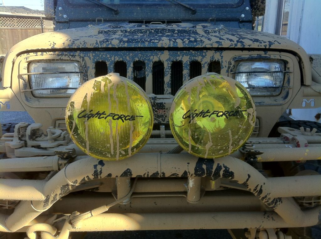

HID's have a good output and are worth looking into but there are many ways of cutting corners especially by going with a cheap kit. When it comes to lighting, you get what you pay for. If you're gonna light up your A pillars, perhaps a little more versatility would be beneficial. The lightforce 140's fit nicely in that location and can change from spot to flood in a matter of a second just by rotating the housing similar to that of a mag light flashlight. Most people put spot lights there to avoid glare. KC has some scoops that mount in that location to reduce hood glare but they look ridiculous.
These are the 170 strikers but the 140's are a little smaller by 30mm. Same features including interchangeable lenses for different driving conditions and weather. Colors and throw are both mixed and matched to give you the best light for your application.
