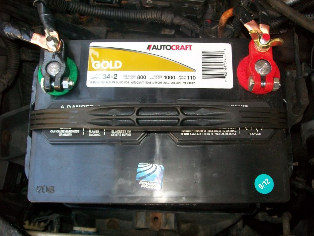

I had one installed in all 7 of my Triumphs and i have on one in my ZJ now. If installed correctly, i.e. tight, they are great.
Make sure your connections are tight and clean and you should have no problem.

Personally, I'm a big fan of marine terminals. It's just as easy to disconnect, and it makes it easy to add +12v lines for whatever you want.

marine terminals aren't generally up to the task for offroad vehicles and accessories. don't even think about adding something like a winch to them. they've been known to melt under load.
same with the screw in/auxiliary terminals on actual marine batteries, not recommended for that kind of use.

OP has a stock 2wd I6. It was just a suggestion. They've fit my needs well over the years. The most I ever had hooked up was two foglights, a Harbor Freight power inverter, and a amplifier. I don't think he needs to be paranoid about his melting and setting his Jeep on fire.
But I agree, for any kind of serious draw the marine terminals would be the weakest link.

The whole thing was I just replaced the harness about a year ago{mega bucks mopar} and the negative terminal is getting weak from the off on cycle. I was just looking for a way I could leave it alone and just disconnect by some other means. Some of them are plated brass which I wont use, but the moroso one was a dull color so I was thinking it might be at least closer to a base metal. I really didn't want to hack off the negative clamp to use something else, since I don't trust a crimp on terminal unless it had been crimped and filled with solder{pellets or silver soldered}.
