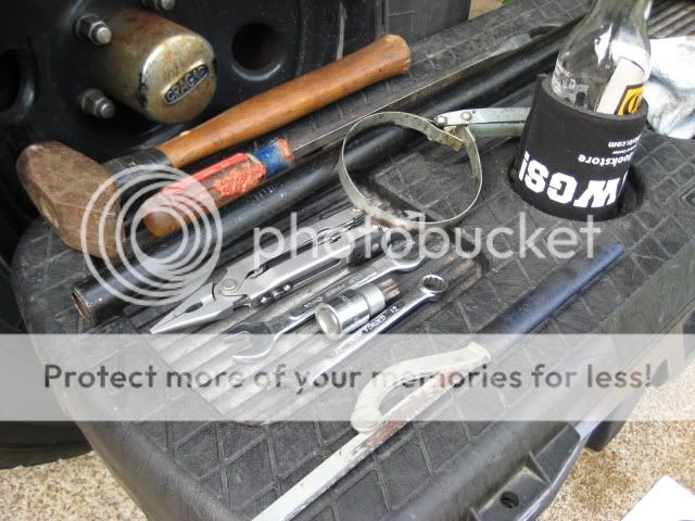

Guys, just did the notorious oil filter adapter o-ring replacement. This worked like a freakin' charm! First, the jeep tools du jour:

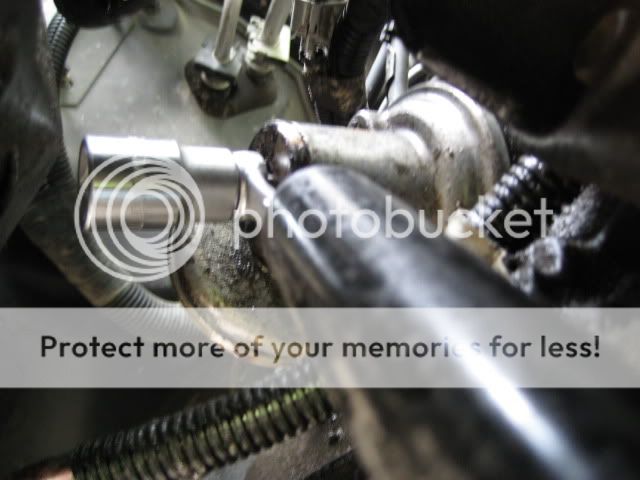

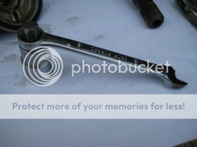

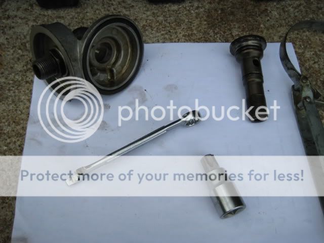

When the T60 torx bit is seated in the adapter bolt, it leaves enough room to get a wrench on there ( I used a 12mm closed end). the wrench is a cheapo that I cut/broke so I could get it in my breaker pipe.

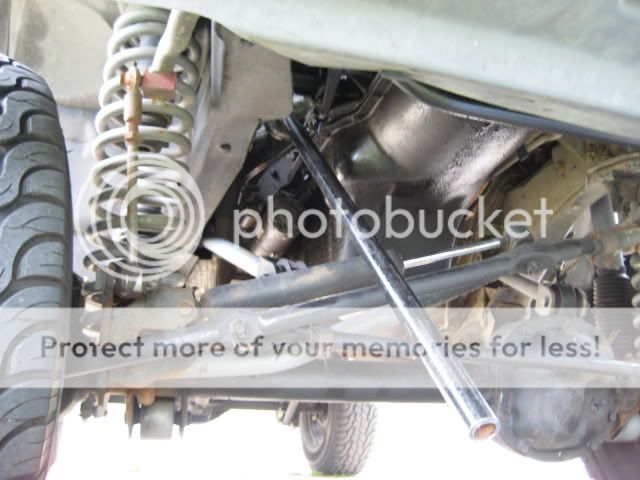

I inserted the torx bit - wrench combo, then put the pipe on it, tilted out over the front axle and steering linkages, and broke the bolt free with only a wee coating of elbow grease.
It actually took me longer to cut and break the tip off of my 12mm wrench than it did to remove the oil filter adapter.
