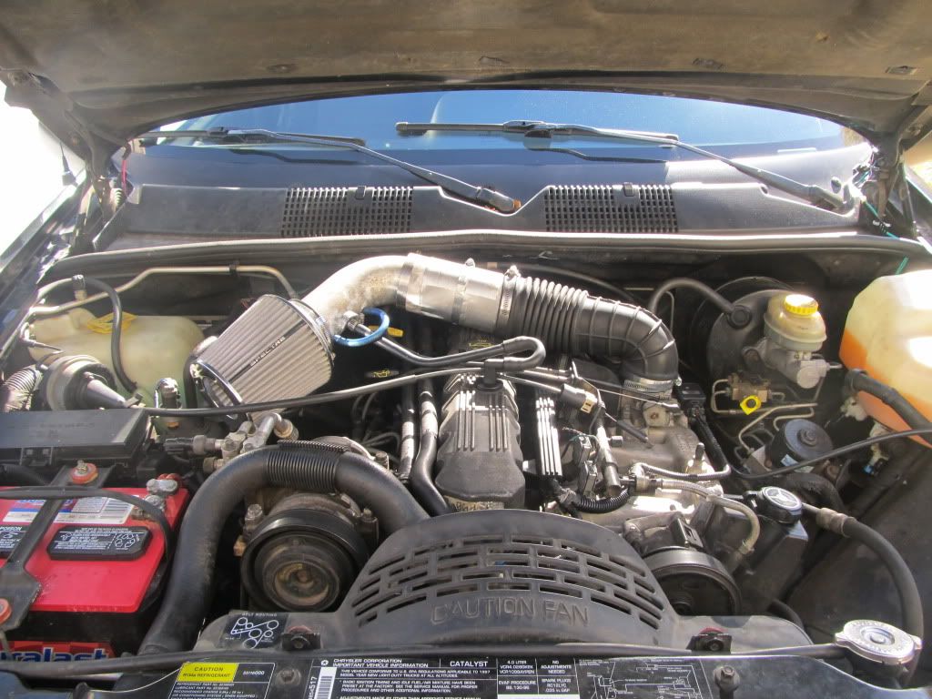

Yeah I have to finish the hole in the cowl, weld two plates and finish the hole with 1/8 rubber sheet for a "heat resistant" water tight transition through the firewall.
At idol, the aluminum tube feels cool to the touch, much colder than the running engine. Plus im avoiding hydro lock and water intake, the functional part of the CAI was just an added bonus.
I also added an electric fan, with the intake and fan, you can really feel a difference in the throttle.
Not to mention the intake is loud as hell. Haha. Love it.

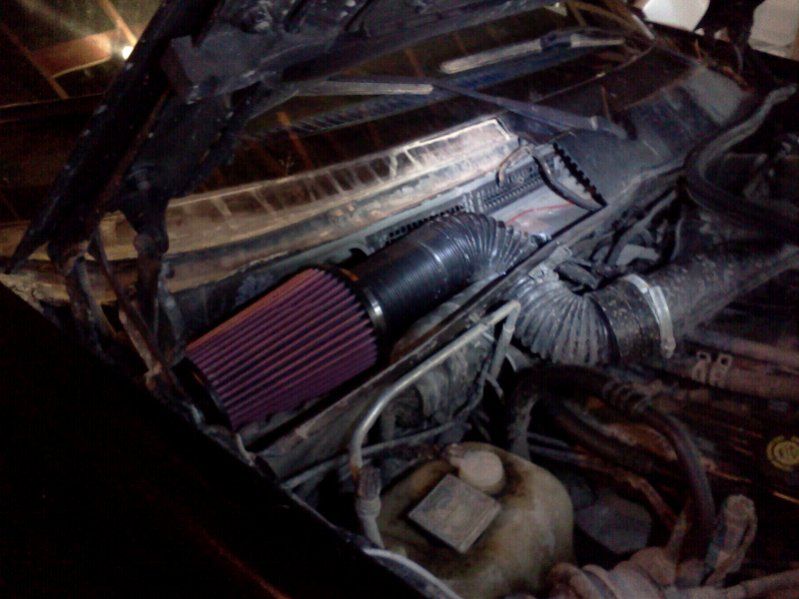

Tuesday i have off from work so im going to put a 90, or a 60, degree the end my intake and run it more inside of the cowl where the heater box gets it's air.
Hit a water crossing with too much gusto and had what looked like a 1" wall of water on my windshield that ran into the cowl and hydro locked. Mind that the water level was up to my hood anyways...
No damage. Pulled the plugs and pumped the water out and continued to off road all day.
Crossed that same spot twice more just slowly and had no troubles.
Is there a specific filter yall got for this set up? I was lookin at gettin a k&n cone filter for my set up, just didn't know about size and fitment :thumbsup:
There is actually, when I first did it I bought an autozone filter but it didn't fit, so I hit it with a bfh till it did. I was sorta worried that waa bad so I got an airaid filter off of summitracing. When I get on my comp i'll post a link.

I really like the filter in the cowl like that! I had an XJ and just ran a hose out the back of my stock airbox to the cowl. (cant do that on the ZJ, washer fluid in the way)
One time I sank my XJ's nose in a mud pit nearly to the wipers! engine COMPLETELY submerged the front of my jeep, cowl intake worked great! (although I did have to get yanked out by a Deuce and a half...)
Have to make sure it stays relatively clear of mud and snow, but worked great. Im sure itll be the same on the ZJ!
That pic actually isnt mine, I dont usually ford anything past my doors (got a nice stereo system an dont wanna short it) I just relocated it so that I wont have to worry about the intake being quite so low.
