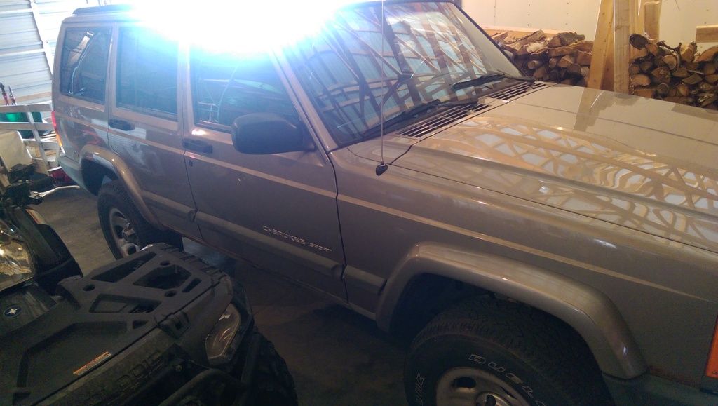

I had already found my next xj to build, hyper sweet grey ride which the previous owner had already dropped in a pile of new bits (head / radiator / water pump / battery / alternator). Picked it up and its sitting at the shop waiting for the suspension adjusts to get the new tracks to fit (they arrived a couple weeks ago).
Here's a bad pick of grey beard the xj
