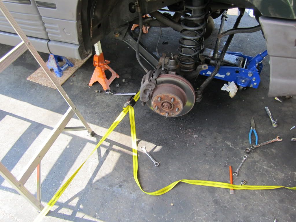

If you're close to a bush, some ratchet straps may help get everything lined up. That's what I used. If you get some tension in the direction you want things to move then give it a push, sometimes it will just fall into place.

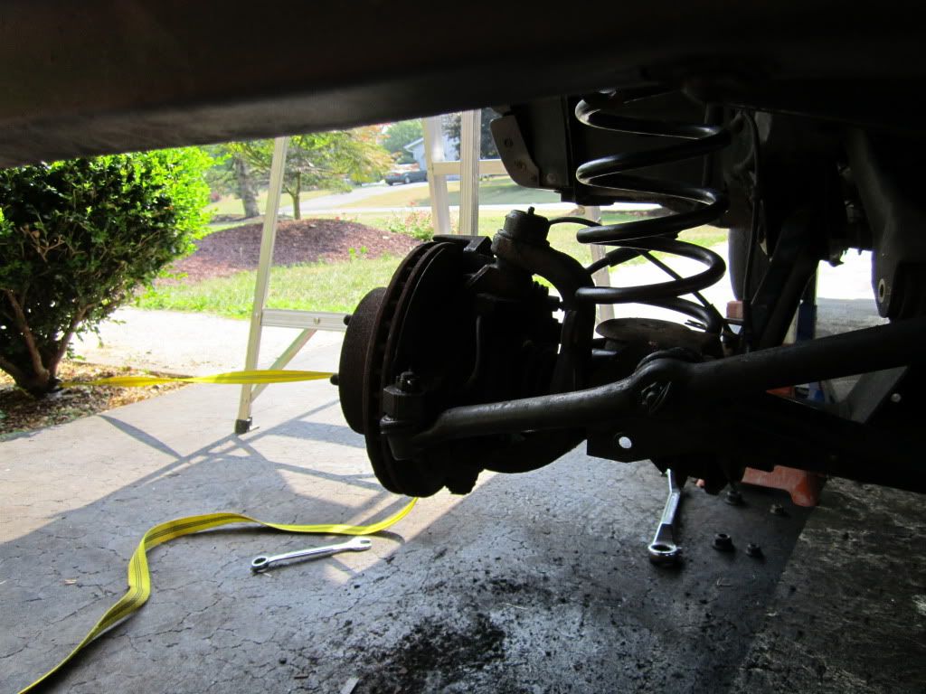

I put springs in absolute last. So, both lowers first, then uppers (if your kit came with them but I doubt it), then springs. Flex each side out to fit springs in. I've done multiple lifts this way with just simple hand tools and it works great. Also, with the springs not in, you have much more finesse over the front end without having to fight with the pressure from the springs.

I just installed that same kit a few months ago. The axle needs to move forward a bit. I got under there and just kicked the axle until it moved far enough. Concentrate on one side at a time. Kick one side out so its crooked, loosely install the bolt, then kick out other side. It'll move, trust me.

LOL we had to use my freinds winch on his 2500 to pull the axle back far enough for the rear ca's to fit...then some prying and busting a** to get the bolt to line up. it aint no cake walk.

Doing one side at a time helps a lot since the axel wont move rearward so much. I remember using a 2x4 and the stock bottle jack wedged horizontally to push the axel forward one side at a time. It takes a bit of trial and error, prying and a couple light taps on the bolt once you get it lined up. Remember think of your safety first! Don't become a pancake.
