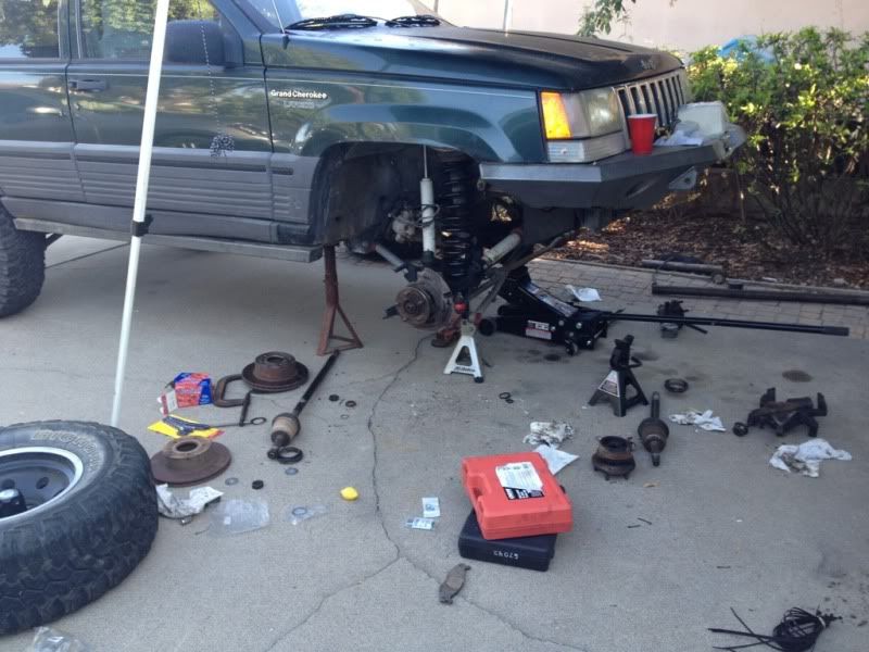

Sorry for the lack of updates. Haven't been able to get much done for quite awhile but here goes:

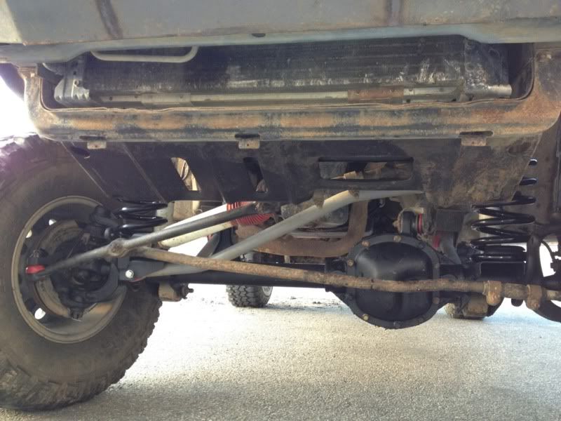

I've completed the long arm install, upgraded the steering with rusty's hd offset steering setup, finished the stinger, and now I just need to finish the exhaust.
First off, the rough country long arm kit is NOT a weekend driveway bolt on kit. In the end, I welded the rear long arm mounts (and will weld the transfer case mount when I get time) and rented a plasma cutter because trying to sawzall the rear control arm mounts is just comical.
The steering was hitting the swaybar mounts after installing the 5.5" springs and long arm so I went with the rusty's hd offset setup.
