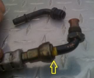

Is it leaking from the yellow plastic clip? I have the same problem took it apart twice still leaking,replaced the rubber grommet twice at wits end right about now.

I hear ya. My story is my radiator cracked the plastic side so replaced the rad with one from advance, it came with a different rad connector. Replaced the oem connector with new one, now when the hose gets pressure it leaks at the connect. Replaced the grommet twice still leaks HAVE NOT been driving the jeep since it happened.
I'm going to the dealer in next couple of days hopefully my frustration level doesnt go into overdrive. I don't wanna jinx myself but I can see walking in the parts depo with the hose and them telling me they dont service/stock 1995 jeep parts anymore, fingers crossed.
On a side note the hose did have grime all over it running down from the connect. I'm guessing it sealed itself with crud over the last 16 years and now I broke the dam so to speak.

Well put an new plastic quick disconnect and another new rubber grommet and its still leaking. More of a slow trickle than the full on flow it was doing. Would a gasket sealent hold the leak after it dried or would it work itself free, open to suggestions

Can you take some pics while your at it please, what you guys are describing might be my only solution. I just need a visual reference
