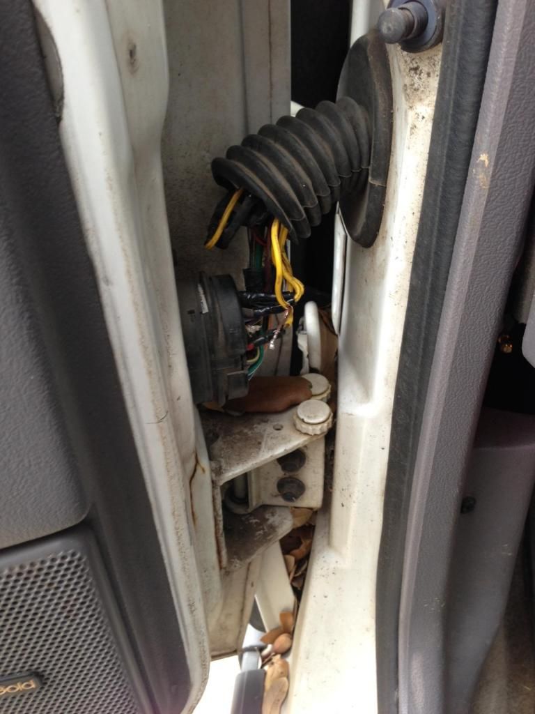

well after opening up the boot covering the wires on the drivers side door I found one wire that was broken, just a single wire though, i tried cutting some of the jacket back and touching it to the piece that was exposed coming out of the door and no luck, although the metal seemed very deformed and like it had old solder on it, basically a nub.
how do i get the wire coming out of the door out and replace that single piece? Would that one single wire cause everything to go out? Again, the two front tweeters are still working just fine...

If its a speaker wire it could knock out just that speaker. But not the other 3 unless they have broken wires as well.
If your tweeters work with the amp unplugged chances are the amp is the cause. Speaker wires run through it so if it isn't on they won't work. Could be as simple as the fuse or a loose connection.
If they don't work with it unplugged then you have a wiring problem.
