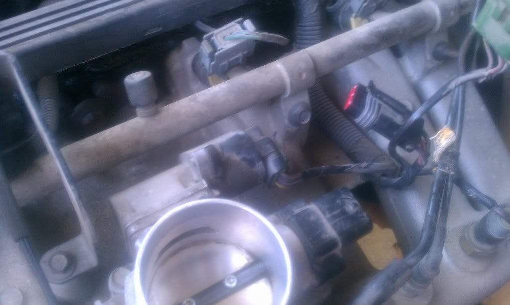

Ok, just cleaned the throttle body (did not take it off) but cleaned inside, opened the plate, seems much better now, although I'm skeptical it will help.
In terms of the IAC, I took off the module right behind the TB that is held in with two screws, I saw no nipple, refer to the picture below, is it the unplugged module or the module that's still plugged in?

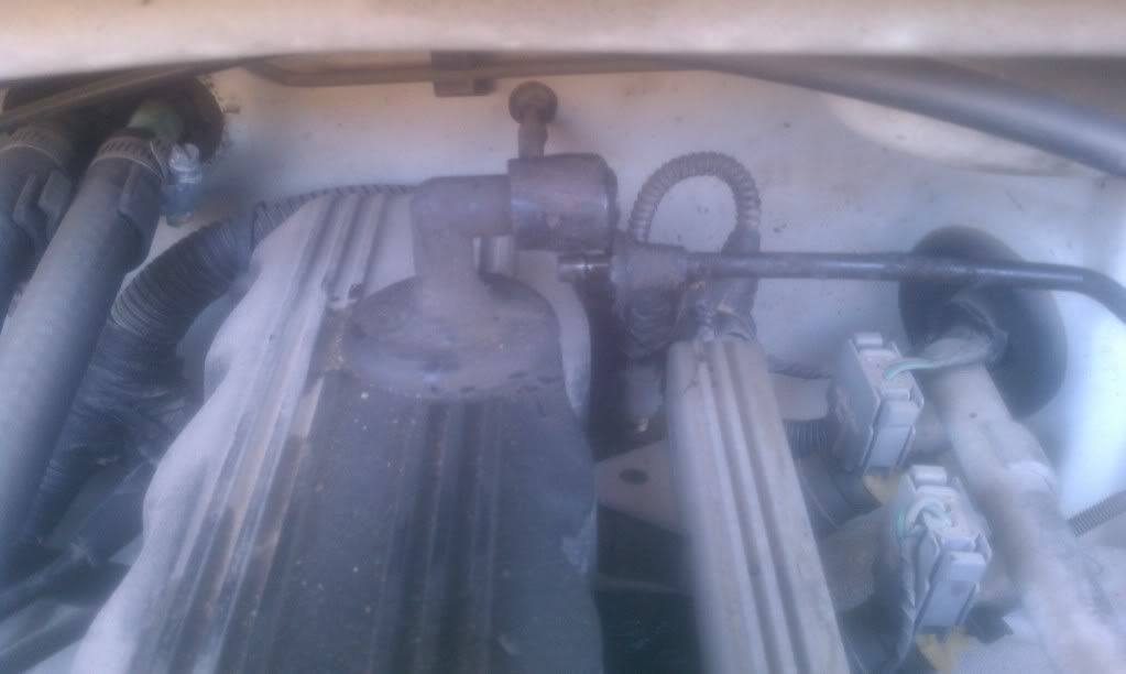

Also, while working/taking that off a hose coming from the top of the motor knocked loose, although after taking a look at it, it was clearly already broken, what is this below?

CCV valve, that needs to be replace if its broken...
it takes clean air from the front of the airbox and puts the unburnt mixture back into the intake.
that's why a clogged rear line will cause oil to build up in the air filter
As for the controller The one thats screwd into the throttle body is what you need to take off
What you have unplugged is the TPS. IAC is the other one
LOL, broke off the SAME exact part. $6 at parts store.
