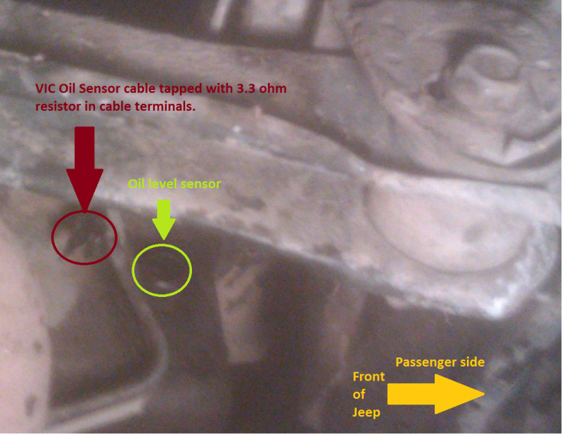

Greetings all,
I'm getting the dreaded "CHECK OIL LEVEL" warning on my VIC. Previously I just used a resistor as discussed in other threads to fool the VIC on my (now deceased) 4.0 and it was easy to find as the sensor connector was just hanging there. For the life of me I cannot seem to locate this sensor on my 5.2 V8, does anyone have a picture of it? I would be immensely grateful as Google and Forum searches haven't given me any such results.
Thanks in Advance!

It is on the passenger side,

Awesome, thank you for the diagram!
I was able to get under the Jeep for other work and took a picture of the above diagram should anyone need it. I used some zip ties to secure the cable to the rest of the wiring harness.
