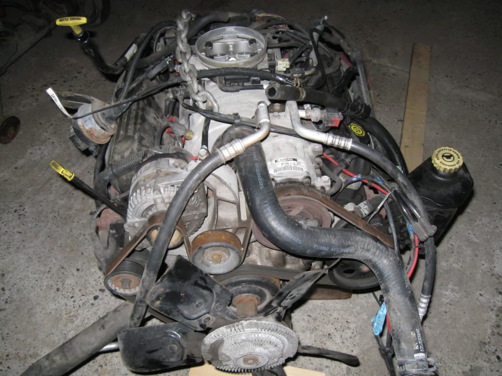

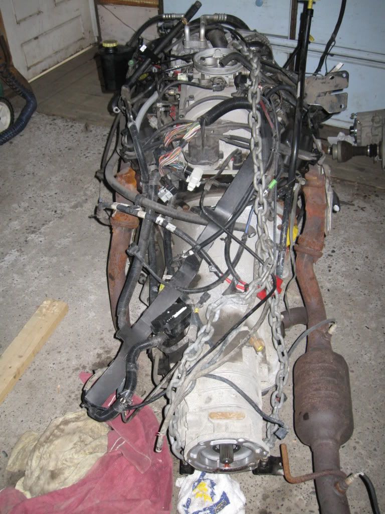

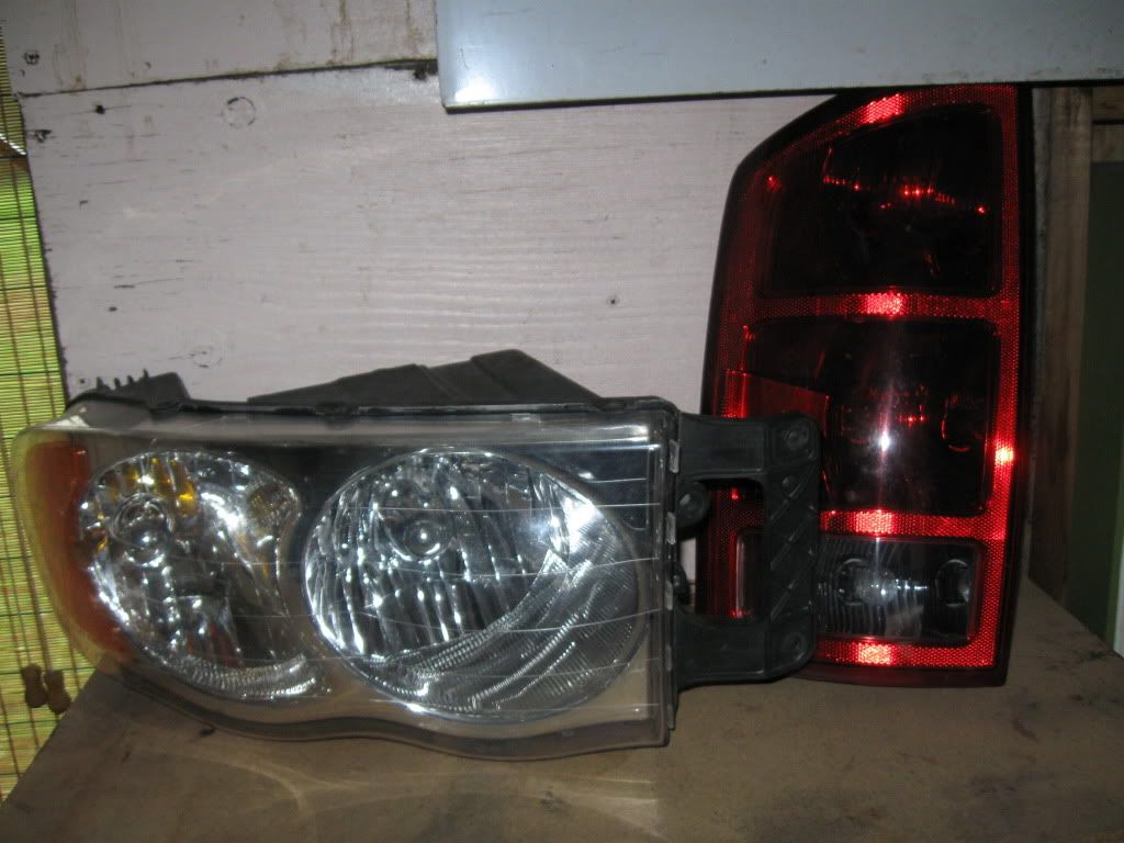

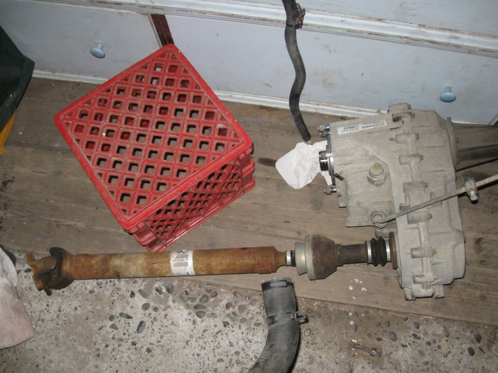

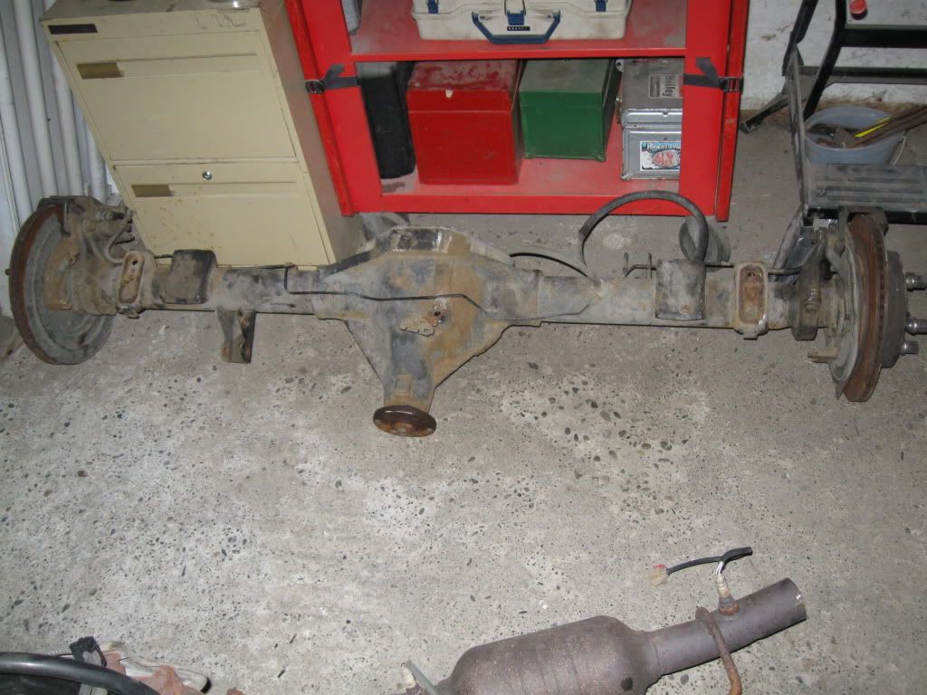

It ended up being $700 to clean out his shop. Here`s some of the stuff I got and a picture of my Jeep taken today.
