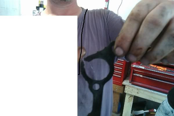

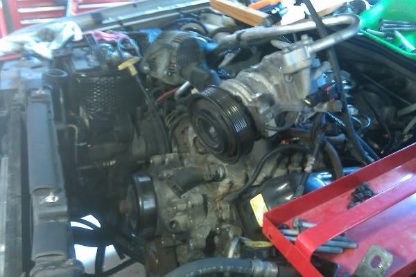

Here are some pics from my project when my timing cover was leaking.

It isnt an o ring kit, its a replacement metal tube for the heater bypass. However its a short dodge version "ours are long" but the O ring is what you want on it.. The only way to get these "special" o rings is from that tube kit, or from a waterpump box or the felpro gasket kit. Your waterpump should have 1, and i bought 1 of those tube kits, took the o ring off and returned it for another one so i had 3 o rings lol. I tore one, the 2nd went on fine and i have a 3rd extra. The part number on autozone's website is 56399 , or just type in heater bypass tube and pick the 2nd one
The oil pan doesnt have to come off as i said. The timing cover is held on by 2 bolts through the oil pan. Take them off, take the timing cover off and the oil pan has a lip hanging open. Take a rag and cover the openeing so you dont get old gasket material or something in your oil.. When you reseal everything clean the old gasket of oil and dirt and put RTV over it so it wont leak when you put the timing cover back on.
Yes i replaced the front main seal on the timing cover for the crankshaft. No i didnt buy the sleeve kit for it. I forgotr what the sleeve thing is for but mine didnt need it. Just get the fel-pro gasket kit for the timing cover and water pump without the sleeve. Oh and that kit will have a o ring as well lol
