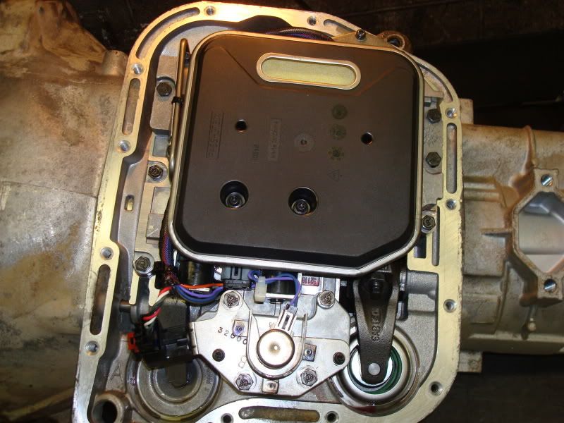

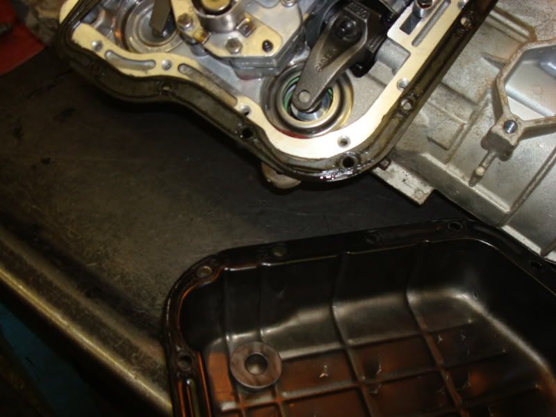

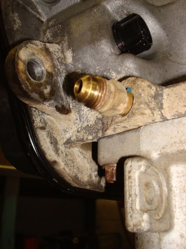

push it into place it is alot easier if you lube the connector orings and shift shaft seal first
torque bolts to 100 in/lbs install filter this one has the deep pan with the deep filter
reusable pan gasket and remeber magnet in bottom of pan
if this bolt is too long the neutral safety switch will catch on it ... if the neutral safety switch is in place and you put too long of bolt here the pan will leak like a bastard and you will think it is the neutral safety switch leaking
****** DO NOT OVERTIGHTEN THIS FITTING IF YOU REMOVE OR REPLACE IT YOU WILL CRACK THE CASE YOU WILL CRACK THE CASE ***
sonnax makes a fix if you do crack it BUT just DON'T crack it ok
TA DA your done

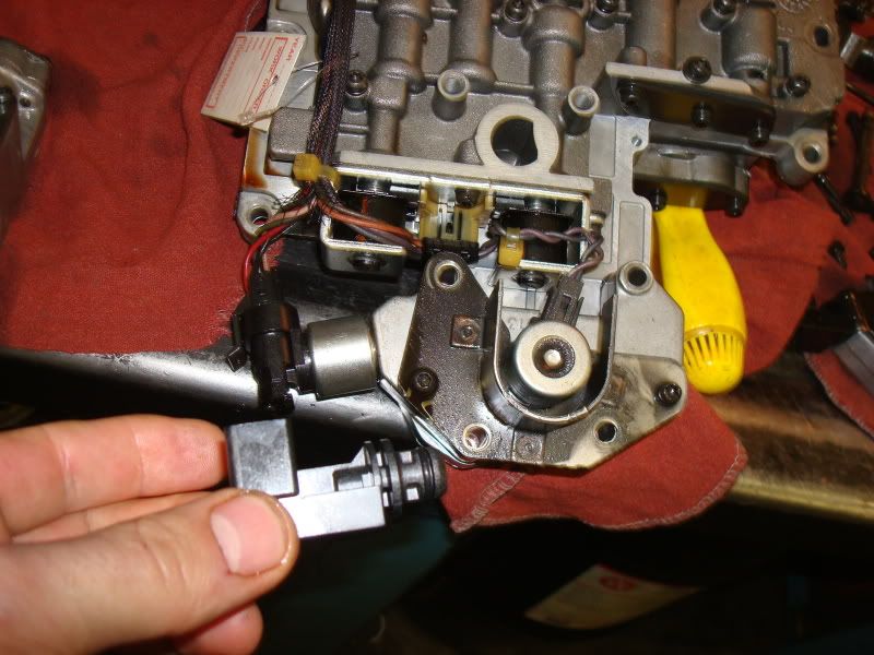

couple extra pics this is the older style govenor pressure sensor compared to the newer style not interchangable
