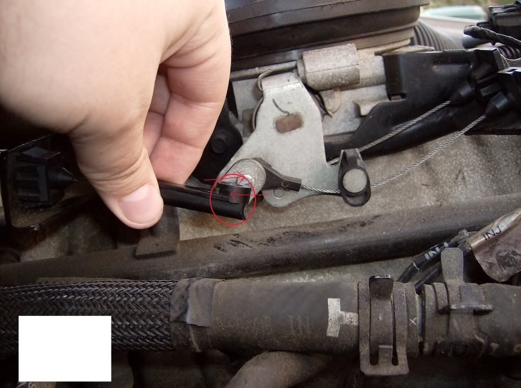

The cable you mean the throttle valve cable right ? That an easy one to do.. Take the white clip off on it. It opens by splitting it on the top and bottom (dont break it) then the black knob on the lever pulls foward to pop out (dont pull it out or youll break it... it pushes foward towards the front of the engine). Then grab the black part of the cable in the back while holding the black knob and push it foward or pull it back until the center line on the black knob lines with the knob on the throttle lever.
Here are a couple pics of what it should be aligned too see the arrow pointing to the line on the black thing ? That line needs to be lined up with the other arrow. Dont pull the cable to align it, you have to grab the cable in the back that is sheethed after you take the white clip off to adjust it right. However if yours has slack that really only means your Jeep wont shift into the next gear.. too much slack and it will hold gears too long, to little slack and it will shift to fast

Thanks for the info and pics. I adjusted the cable and had quick shifts and delayed shifts just like ive been reading. The Jeep is still nuetral dropping like crazy/ taking a few seconds to grab and go in gear.
