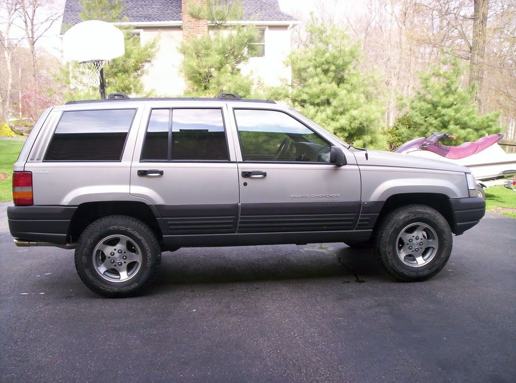

Before and after pics from the same week.
Stock suspension on 30x9.5 GSA's -
31's, Cragar Steelies, 2" BB. Sorry for the blurry pic, the only picture of my Jeep totally stock besides that setup.
