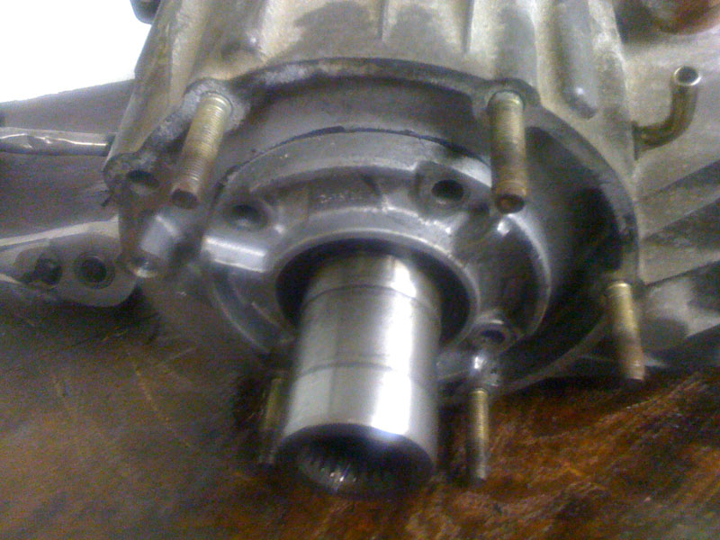

Ok so I just ripped down my 242HD to swap in a new shaft for a sye and decided to replace the 3 bearings while I'm in there.
So far I got 2 out but I cant figure out how to get to the front input bearing.
I took the 4 bolts out and beat on it for a while and it won't budge. I also tried prying with a screw driver in the 2 slots and no luck.
So I'm assuming something is holding it from the inside? Trying to get to it from the inside, I can't figure out how to get the forks out to get there.
Any advice would be awesome.

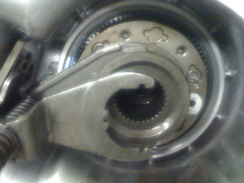

Well **** i got the front cover off and I'm at the bearing but it looks like I need to drive it from the inside out. Unless someone has a method to pull it from the snap ring grove on it. I can't get that damn roll pinout either. What a ****ty evening

yea, it comes out from the inside out. i was able to remove my forks w/o even messing with the shift gate.

just pry the forks out. be careful, its not that hard.
after 4 times of taking my tcase apart i drilled out that little pin and have left it out just so i can yank the main shaft itself out. its held in place by the case covers so i shouldnt have to worry about it moving back and forth

I'll try prying them out tomorrow, my luck I'll end up with a broken case.
