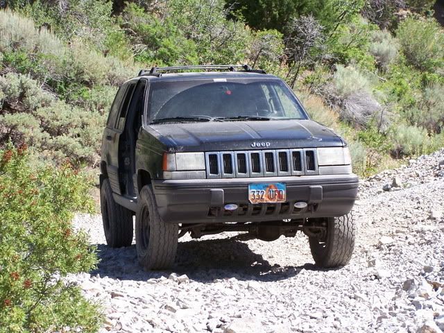

30s, stock Upcountry suspension. Rolled better than on on 235s. MPGs dropped 1 solid MPG jumping to the 30s. But no significant difference on the street or highway. Oh, 4.0, 3.73s...
This is right after I did the 2"BB over the Upcountry factory lift. So, lets say 3" over stock. On 31s. Lost 2 MPG on average. Didn't feel as "strong" when passing on 2 lane roads...
Same as above, forgot to disco the front swaybar. Homemade discos...
Back on 30s, MPGs back, and seat of the pants power is back. Although, the Falken Rocky Mountain ATs are HORRIBLE in the snow. I got stuck in my own driveway...
STOCK, on 235s, this went more places than I expected. But I wanted a little more height. I needed to keep the ZJ as my DD, as I carpooled with others. So, the 2" BB over stock was perfect. Jumping from 235s to 30 before the BB install, I lost 1 MPG on average. After the BB and jumping to 31s and I lost another 2 MPG. Switching back to 30s gave me the 2 MPG back, and I feel like I have the power back I lost with the 31s on the highway.
Funny thing, I'm considering a spacer lift like the Subaru guys do, on my 2003 Neon.
