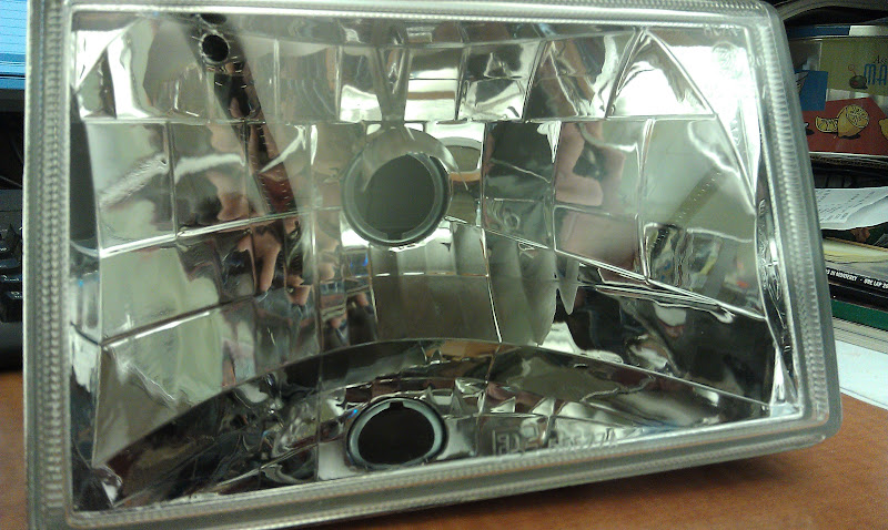

So I am happy with the output of my current setup, but I want better aesthetics. I figured while I am at it, I might as well just upgrade the whole setup. Currently I have custom housings made with the OE reflector housing (Painted flat black) and custom Lexan lenses with VHT. I have a 35 watt, 4300K, VVME HID kit. I also have the MH1 3.0's in there.
So for the new setup I ordered...
-MH1 4.1's (Thanks Matt @ TRS! - Will be here Thursday)
-50/55 watt VVME HID kit - 4300K (Will be here Friday)
-Crystal Clear Headlight Housings (Will be here Wednesday):

Headlights arrived today:
Projectors tomorrow & HID kit hopefully by Friday.

Hahah that's awesome. Those guys are super nice. Love working with 'em.
I'm thinking the end result will be somewhat similar to this but I have a different shroud, and the projector lens is going to look black, not clear:
