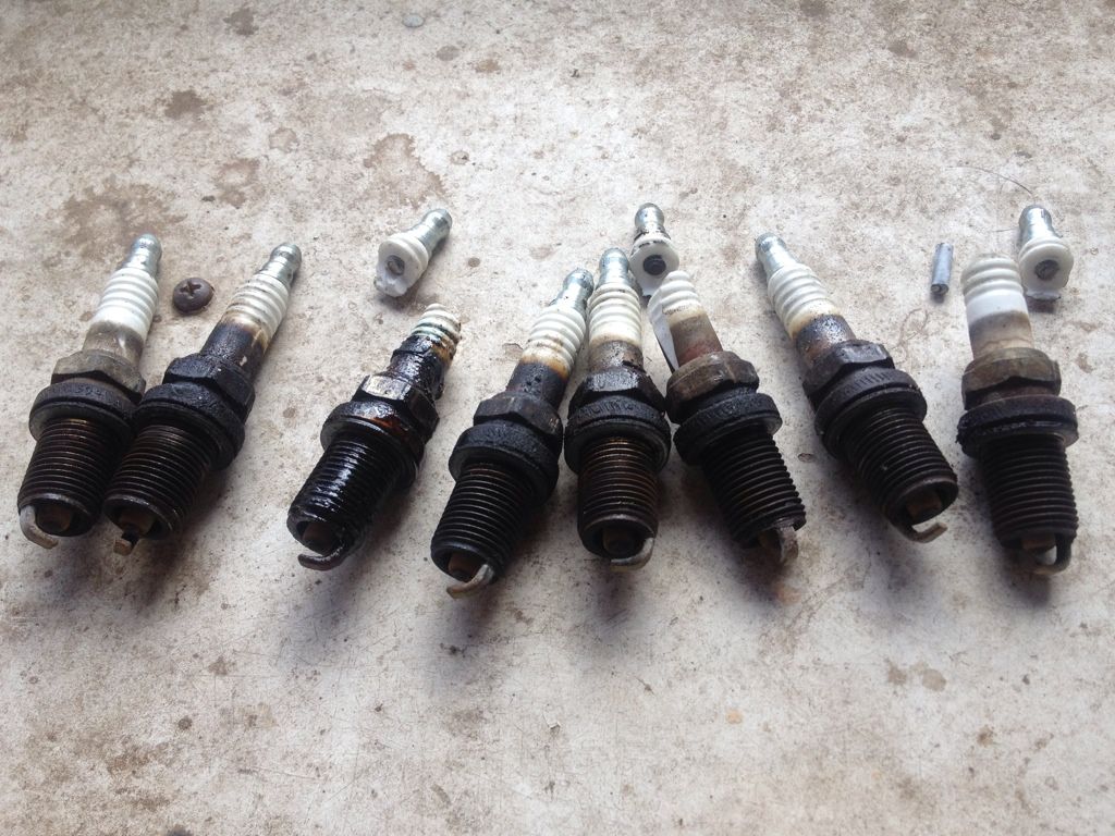

not as evil as mine were, i had this to contend with
broke off all the threads at the #4 cylinder
Holy crap! I'm sure as hell happy I didn't do that! How'd you get the threads out??
i used a #5 screw extractor, which is junk now because i cant get the piece of spark plug off it!
im fairly certain they were the original plugs, like factory original. it still had the chrysler plug wires date coded 6/1995. after that one broke, i sprayed PB blaster on the rest of them and let it set overnight. had i not done that, i think more wouldve broken, because they were still all very hard to break loose. i put anti seize on the new plugs so i shouldnt have this problem again.

Originally Posted by a20ftsloth View Post
Today was kind of an adventure... Put some new iridium spark plugs in. Gapped them at .38 each. The old spark plugs were VERY old... The porcelain exploded and I had to use tweezers to pull parts of glass out of the engine haha my knuckles are all cut up. I also got some SUPERSWEET windshield washers and I cleaned the fuel injectors with sea foam. And I also flushed the tranny and put some new ATF-4 fluid in it. And on top of all that I took off the doors and replaced the hinge pins with some new steel pins so the door doesn't clunk as bad or sag at all. All in all today was pretty damn productive!
Those spark plugs were evil...

Man, that old eh? How were they even working? That's gotta be a pretty big gap to jump haha
that gaps weren't too bad surprisingly. The blow by between the porecelin and the metal was really bad though

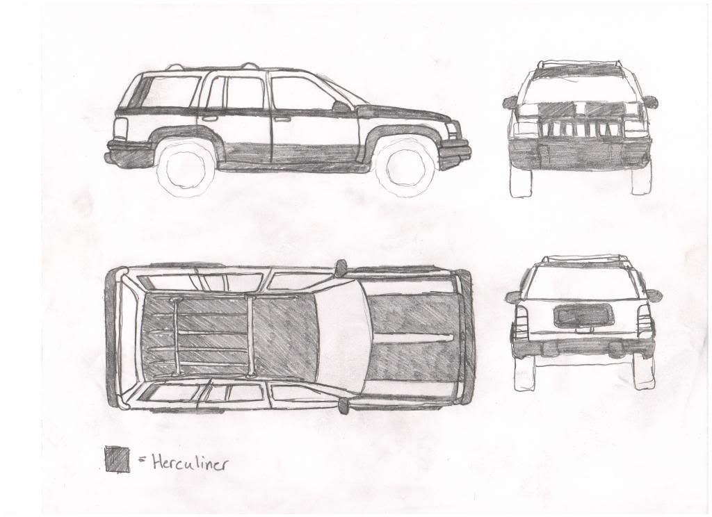

Alright, so I was looking around and I'm really thinking that I'm going to want to try and do a bedliner paint job. I went ahead and drew up the plans. In a couple weeks when I get some cash I'll be able to start it up but it shouldn't take longer than a day. I'm thinking Herculiner.
Honestly I think it'll look pretty cool, and if the paint starts to fade then I'll just use the spray on Rustoleum bedliner to finish the rest. I'd like to personally thank CJNinja for the inspiration. He has an absolutely spectacular build on his ZJ. His build can be found here.

thats some good drawing there!
haha thanks man

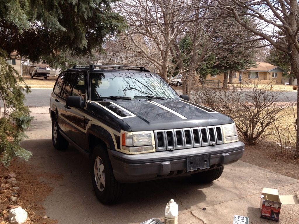

So this weekend I finally finished the Herculiner pain job, although I still have to do the roof. Honestly I'm in love with it, and I think it really separates my zj from the others in town.
Here's what I started with:
I had just washed and waxed it and it really hurt me inside to sand it :'( I was honestly afraid it would look like crap!

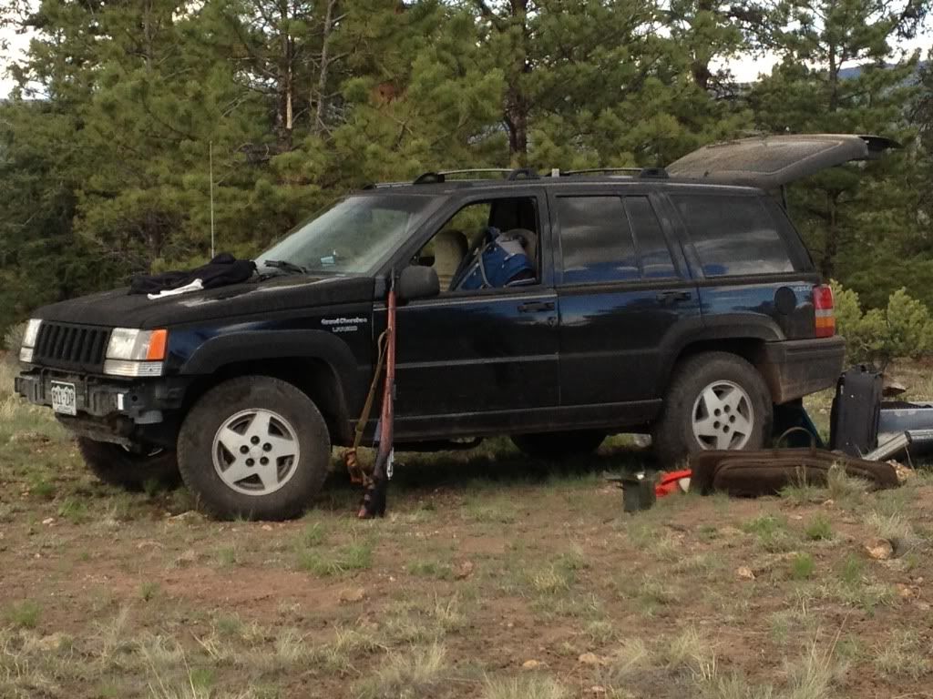

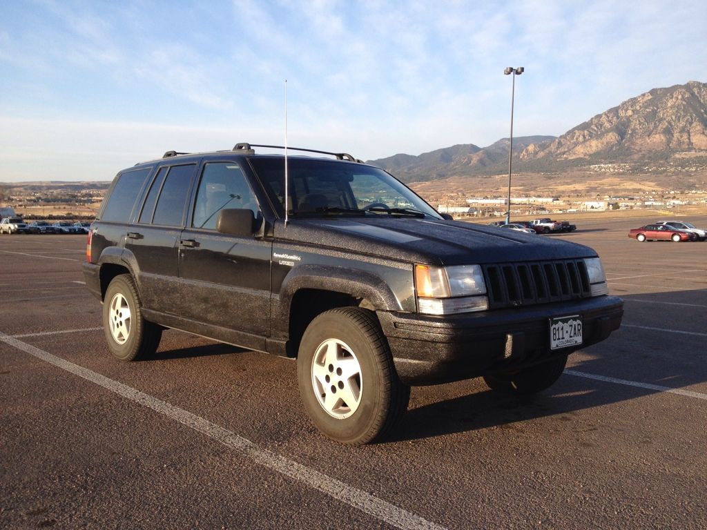

Just wanted to show every body how she was doing. We went wheeling into national forest and it served as an excellent camping companion! The part of the door that the actuator attaches to had shattered two months ago so I needed to replace the door. I still need to bedline it haha but here it is currently.
