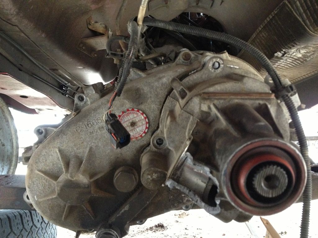

So after a couple days of searching through the junkyard to find a suitable donor I was finally able to find a 1996 Jeep Grand Cherokee Limited that had been wrecked from a car accident. Since its miles were almost at 200,000 I think that its safe to assume that at some point in time its VC had crapped out and been replaced. This one also has the lowest amount of miles that I could find.
Honestly the yard is a little eerie...

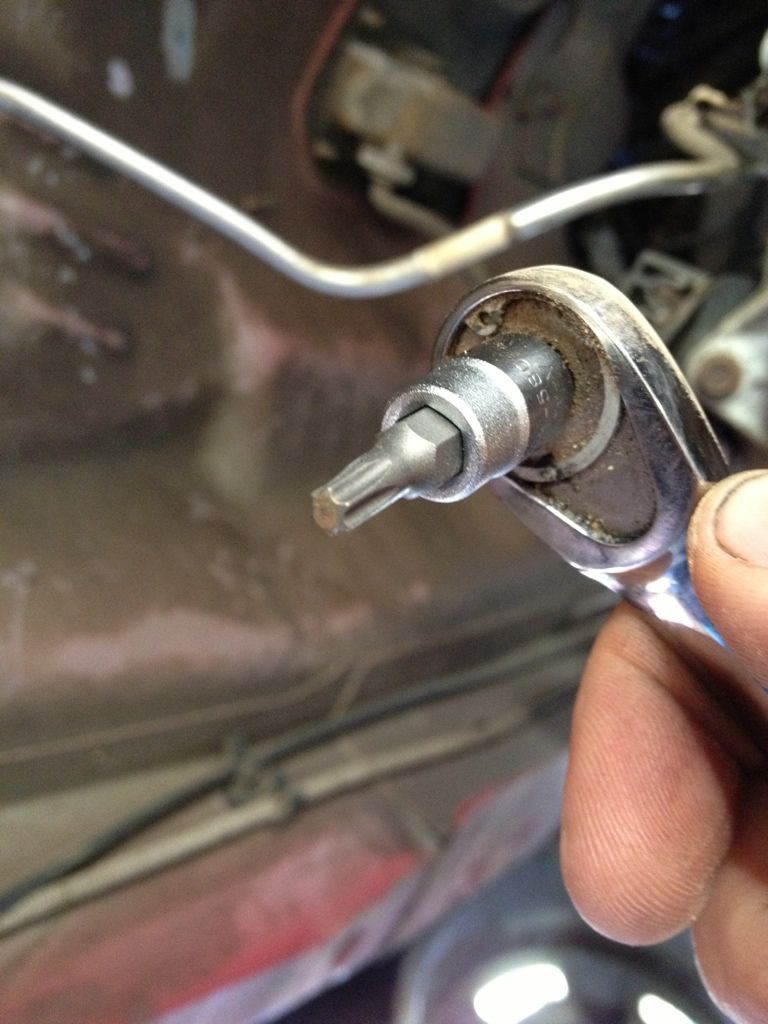

I went ahead and climped underneith it and dropped the tranny and destroyed part of the case because I was a little bored and didn't have the right tools. The next day I did! Those damn torx wrenches and snap ring plyers....
After I got the VC out for 15 dollars it was too dark to continue so I decided to continue the next day. And yes... the VC is very heavy! So I jacked up my Jeep, decided I wanted a challenge and swaped it without dropping the case. It proved to be very difficult indeed.
There's the "newer" VC installed...
And boy does it work like a dream!! According to my calculations I should have anywhere from 10,000 to 90,000 miles till this one dies which means I have plenty of time to save up through college to get a new one, and this one will do just fine.
