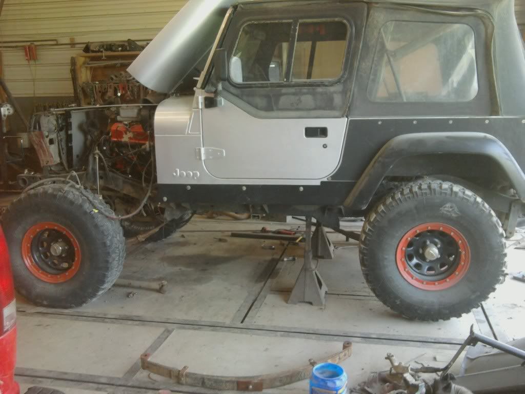

I did the exact bastard pack you are speaking of. Added the main and second leaf from some spare yj springs to my stock springs and only got about an inch of lift. All in all I was very dissapointed with using YJ springs and should have just bough a pair of S-10 springs.

when i first did my bastard packs, i used other jeep springs. I didnt like the end result so i tore everything back out and redid them with Toyota leafs. My springs are off a 85' Toyota straight axle truck. They are a cheap and almost every aftermarket company sells them if you want new...
This is roughly 7" (w35s) over my stock height (w 31s).
1993 Silver YJ. SBC 300hp. 700r4. NP231 hybrid. 35" Mud Terrains. 7" Toyota Basterd packs. 8.8 Welded. D30 loc-rite. 1" body lift. 4" LED tails. Custom bumpers. Warn M8000. Hella's. (Trail rig)
