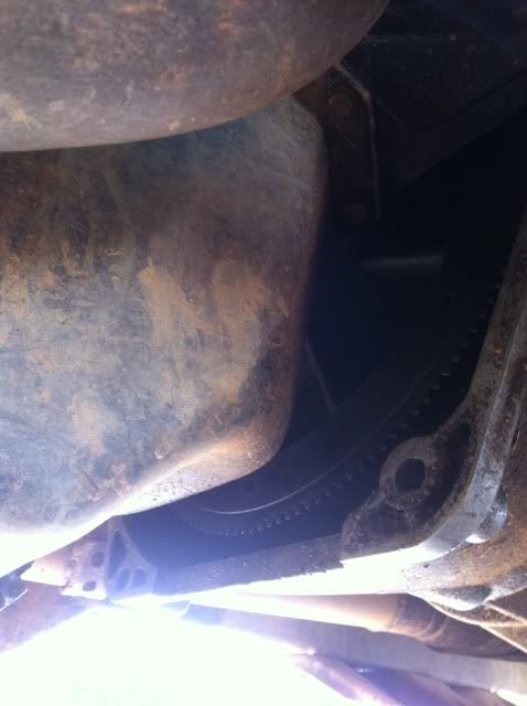

jrayzhunter
Posts: 135
Originally Posted by janders82 View Post
one other thing i thought i'd mention. When the jeep bogs down, I do get what seems to be a very slight backfire. not sure if this will help diagnos or not
I had the same exact problem with mine. Check on the front end of the bell housing and see if your inspection cover is missing. It will be quite obvious because You will be able to see your flywheel. If that's missing you will need to find another one via eBay or junk yard. It messes with your crankshaft position sender which also sits on top of that bell housing. Once I replaced the sensor and inspection cover never had a problem.
Here is what it looked like on my jeep
