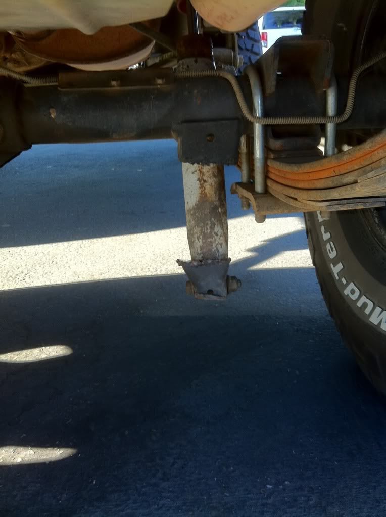

LOL Anti.. is this a common problem for YJs? Was undermine last weekend and noticed my mount is cracked.
I only posted my picture a couple years ago because timatoe and another member posted similar ones. Its pretty common.

Sounds like my train of thought. Broke a shock mount, installed a 8.8
I seem to have the same mount problem, but I'm not quite ready for the 8.8 upgrade. My mount broke in the same place as yours, it seems like the stock mount comes in two pieces and is welded together, is that true? I am interested in your fix for the shock mounts. I have found the terraflex bar that you used but I can't seem to find the 90 degree mounts for the axle yet. are they homemade?

For the bottom shock mount you can get cj spring plates with shock studs on them for a no weld fix.

The standard shock mounts are universal and the 90* inserts are from teraflex on their website. I would strongly suggest fabbing your own at the price they sell them.

I had the same problem as well and went with the 8.8 Upgrade to 4.10 gears front and rear.
I was lucky to get the 8.8 as a donor from a junk exploder and the front I got from a guy on Clist from a 4 banger.
Reweld the spring perches on the rear and install the flange with a new U joint on the rear side of the
drive shaft.
Works amazing.
Where did you find the Teraflex bar? Every website I have found it on says it is no longer available.
Its not completely no weld, but I think it is a good idea. you can modify YJ front spring plates to mount on the rear and mount the rear shock to the pin that would normally hold the sway bar link in the front. The front spring plates are about the same cost as new weld on axle shock mounts.
jeepguy85 I couldn't find the teraflex bar either when I went to try and order it. They are gone forever apparently.

teraflex bars are gone forever. Might get lucky and find one here or there for about $100 or so. They clearanced them out at like $25 a pop a year ago or so.
