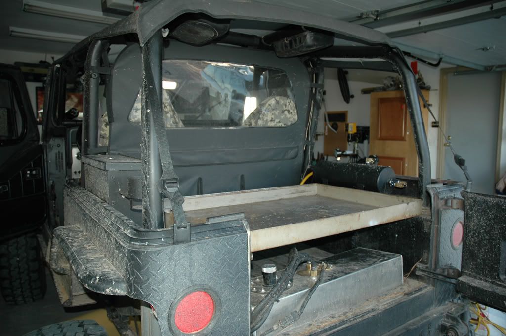

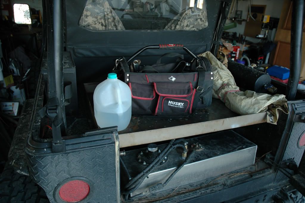

You have lots of options yjc, (it's mine that timatoe posted near the start of the thread). I was originally thinking about having 2 tabs (one on the gate and one on the rack) that would meet with a hole aligned for a padlock to go through since the factory lock is pretty flimsy. It depends how you mount the hinged end because if it's adjustable like mine (not welded to the rollbar) then it's a pain to get everything lined up again if you temporarily remove it for any reason. As you can see, I ended up using a tab on the gate and rack so that precise alignment is not an issue and if I want to lock it up tight I put a padlock on the tire carrier mechanism which locks the carrier, gate and rack all together.
