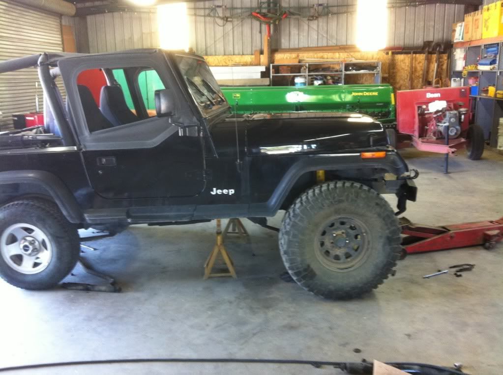

The Restore has Started
OK so here we go striped everything down, getting my YJ all ready for the paint.
I can't wait to see what is will look like when we are done.
